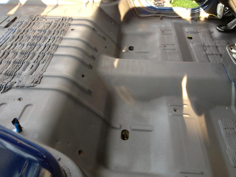

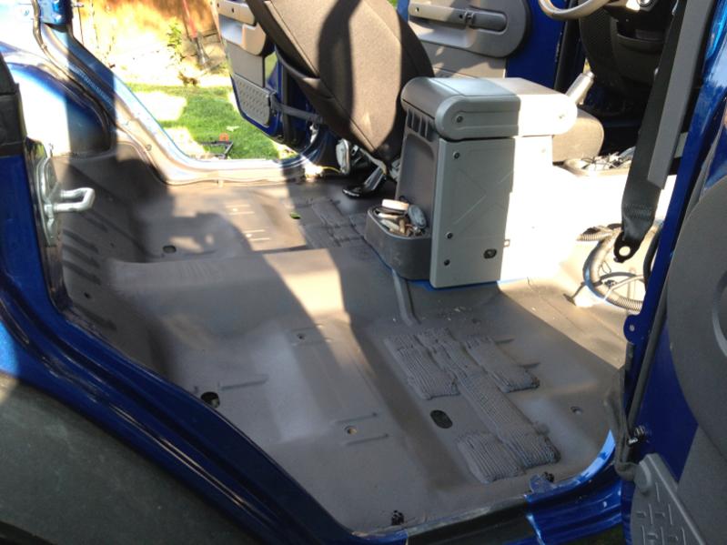

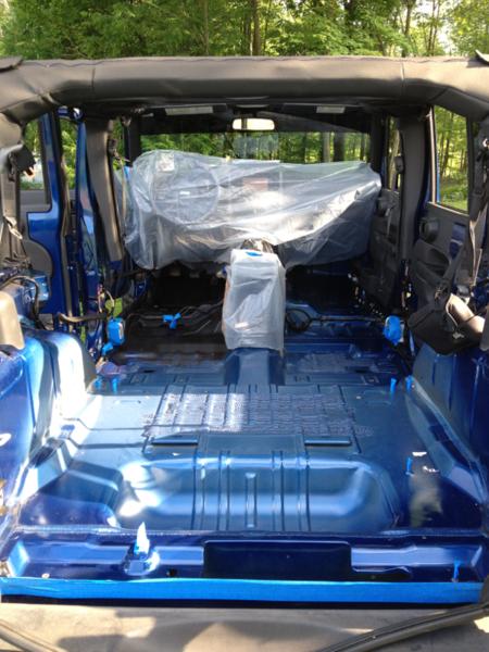

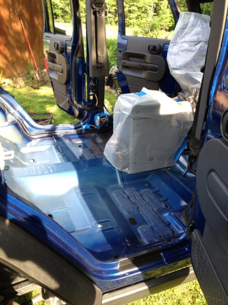

Started to under coat the interior of my jk. I ran out of undercoating,I had bought the two last cans of 3m rubberize undercoat from the auto parts and it wasn't enough to finish the job.so I'm driving around with one seat until I get more.heres what it looks like so far.

Surprised you didn't remove that foam on the floor first. It looks almost like sound dampener.
Otherwise it looks good!
I thought about it.and I figure it would be better if I leave it on.im going to also under coat the whole underneath.so It should hold up.(i hope)

is that what that crap is... i always wondered what the hell that ugly shit on the floor was. i'm gonna coat the inside of the jeep too. looks good!
Yep, if I remember correctly. It is sound dampener and also insulates against some heat.
Looks great.

I removed the shit from my floorboards and some spots had water trapped against the bare metal.
Originally Posted by Canuckjkjeeper
hate to tell you but if i were you i would take the time and remove the sound deadening insulation....that stuff holds moisture. I scraped all of mine off before getting my tub Line-x'd and i can tell you 100% that there were signs of rust under that crap
I stand corrected. It really sounds like got more work ahead of you.
My jeep was owned by a doctor before me that never had the hardtop off. I didn't have it rain inside my jeep between the time I purchased it and the time of removing that shit. Where the water came from I have no idea.

Thanks for the heads up.good thing I ran out of undercoating.lol.ill be removing that shit ASAP
