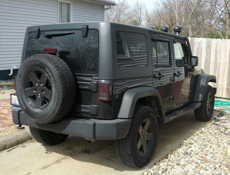

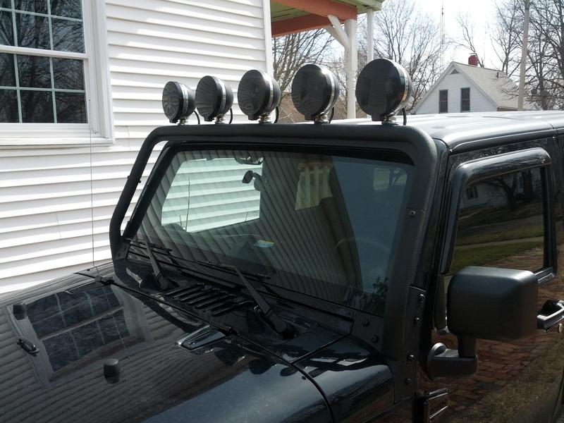

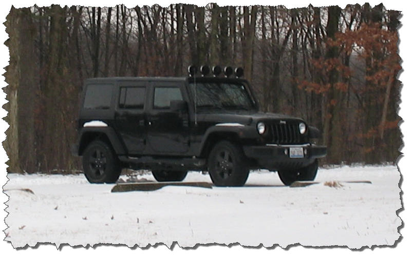

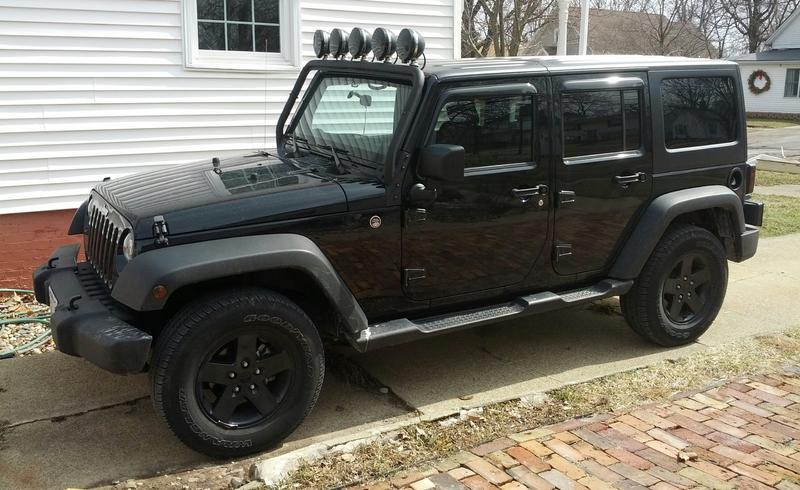

I previously owned a 2001 Land Rover Discovery II which was the perfect blend of rugged but luxuriousness, but she got old and started to break down all the time so I went with something under warrantee. I bought a Black 2012 Wrangler Unlimited, I also extended the warrantee to be a full bumper to bumper for the 5 years my loan is for.
It’s been a great SUV and I'm defiantly sold on JEEP! However I didn’t realize lifting a Jeep can void a warrantee, so im hesitant to do any “Performance” modifications yet, and I’ve strictly done “Visual” modifications. I’d like to complete everything visual first, and then once the warrantee expires life the Jeep and go to town on it and take if from “Mall Crawler” to “Rock Crawler” status! My concern is only for keeping it under warrantee and therefore I’ve only done some basic mods and kept this as my daily driver.
Overall I will make this Jeep more of an “Expedition Themed” Jeep as I’m in Central Illinois and have no rocks to crawl on and I'm not into Mudding. I do a lot of hiking and camping and the Jeep has worked well for it.
Completed;
  • Removed all the stickers,
  • Smoke the taillights, turn signals and fog lights
  • Painted the stock rims black
  • Rugged Ridge Light Bar
  • 5 6” Rugged Ridge 100W lights
  • Rugged Ridge A Pillar Switch
  • Rugged Ridge Grab handles x4
  • Aspen Cargo Barrier Net (for dog)
Visual Modifications to come;
  • Bestop High Access Front Bumper (OR Rock Slide Engenering, Rampage Marathon, maybe Aries Auto)
  • Rugged Ridge XHD Rear Bumper
  • Custom Grill
  • Rugged Ridge Trail Doors (or Bestop, Body Armor)
  • Bushwacker fenders
  • 285/70-17 Nitto Trail Grapper MT, OR Goodyear Duratrec’s (Largest tires i can fit with stock set up?)
  • Possible a Rough Country Body Lift to clear the 33”s if needed
  • Smittybilt CRES net for back
Has anyone else taken this route… done all of their visual mods first and waited to do performance modifications until after the warrantee expires?
Also any opinions on the trail doors, or bumpers I have yet to purchase?

Miless,
The warranty may or may not be voided with a lift, some dealers will void it if it is over a certain height, it all just comes down to what your dealer says. If the dealer says any lifts will void your warranty, then just stick with cosmetic stuff and then once its up go and start the more "hardcore" mods.
As for the body lift, I would try to avoid it if you can. There is a lot that can go wrong with a body lift. I have seen them tear shifter linkages and wiring up within a few thousand miles. You can run a 33 on stock suspension with no issues. I did it for almost a year before I lifted mine and got 35's. If your dealer will allow a small lift, do a 2" Budget Boost (BB) and that will get you more clearance for the tires.
If you are looking at bumpers, the main difference between all of them is styling. That ultimately will be what your choices come down to. Some things to watch out for is that some bumpers will not allow you to transfer factory fog lights over. Others will set your winch up high, which will restrict airflow into the radiator causing the Jeep to run hot.
Other than those few things, congrats on the purchase and welcome to the forum! Seems you already are bitten by the bug (like many of us) so if you have any questions or need some advice shoot me a PM. I also have a 2012 Wrangler so anything you might need I can help out with.

That's basically what I did with my JK. First focused on the appearance and stance, once my 3 yr/30 K warranty was up, performance time.
