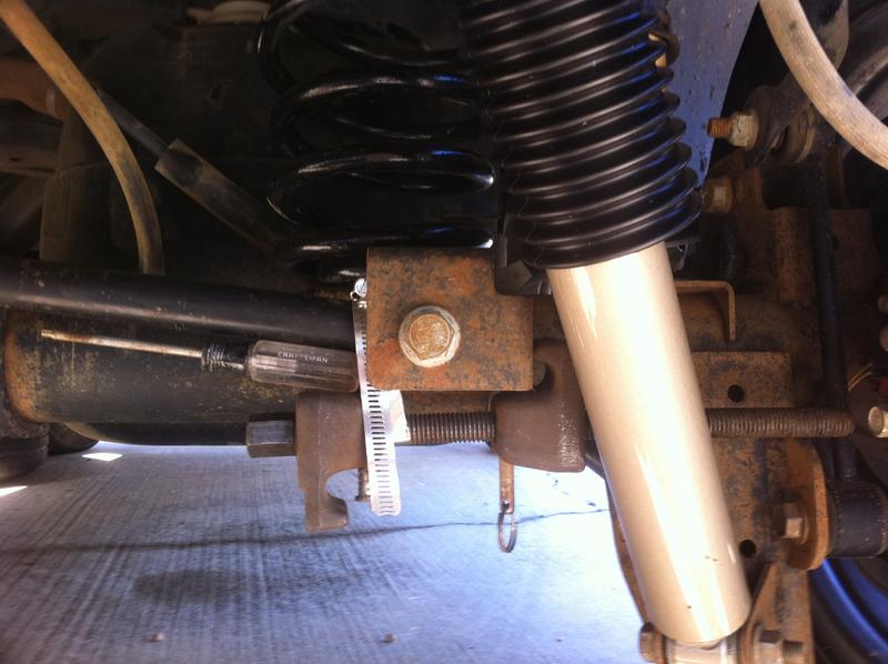

Serviced both diffs and tranny. Put in 18/60 take off springs. Monroe Reflex shocks. Moabs I painted satin black. 285/70/17 Treadwright Wardens.
ID:	280437Click image for larger version
ID:	280440I did this by myself so didn't have a "friend to push the Jeep over till" I could get the track bar lined up. Used a spring compressor, hose clamp, and small screw driver to pull track bar over. Worked like a charm.

Looks you suffer from short a hand syndrome just like Me!
