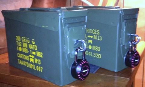

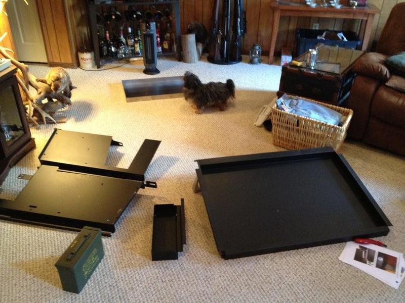

[QUOTE=feholder;2873312]Installed my Tuffy Security Deck (btw thanks to ArmyCop for the great pics on the install)! Before installation added four anchor point locations and bolted two .30 cal ammo cans with padlocks on side storage areas.
Attachment 282848Attachment 282851
Im curious as to if the ammo cans are standalone mounted or are they mounted
to the rack?

They're mounted to the rack shelves with two 1/4" bolts n washers each - may be a little overkill but they're not coming off unless I want them to, lol...

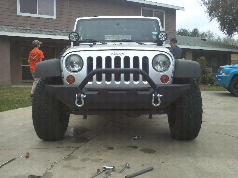

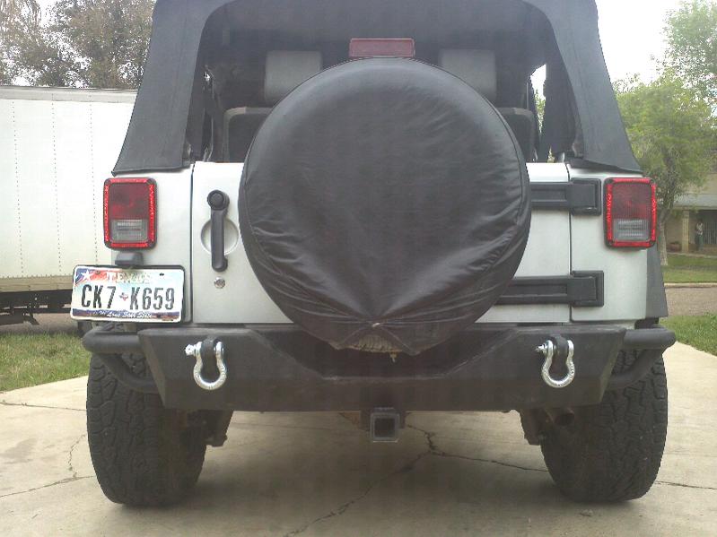

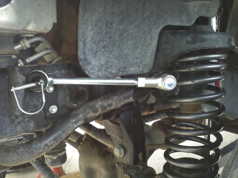

RC dual SS, RC quick discos, RC 2.5 in. Lift and the front and rear bumper

Can you put quick discos, without any other modification (everything stock)??

Yes you can. You an always make your own as well with a cotter pin and hitch pin at lowes to replace the bottom bolt and Velcro or zip ties to hold the links up.

Yes. Discos allow more flex in the frontend. U also can set your swaybar level with them which u want level or slightly up... Not down.

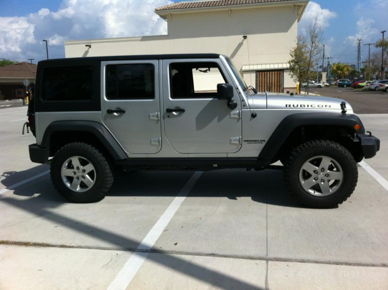

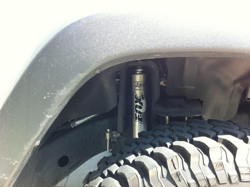

Installed a 2"BB, Fox 2.0's and spacers. She has a respectable stance now. Next up - 35's.
