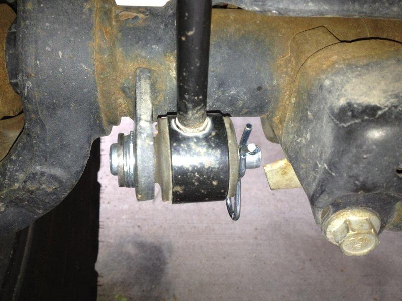

Here they are connected:

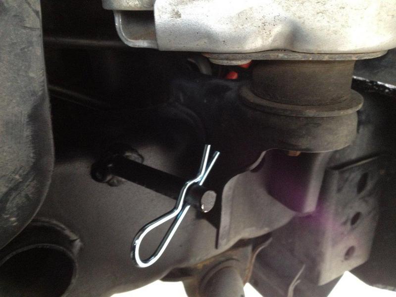

Here is the clevis pin match welded to the frame:

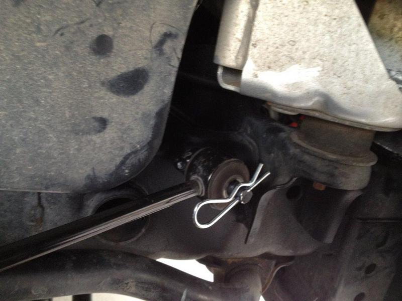

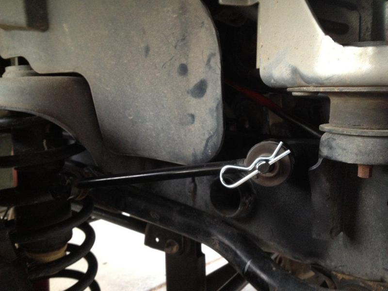

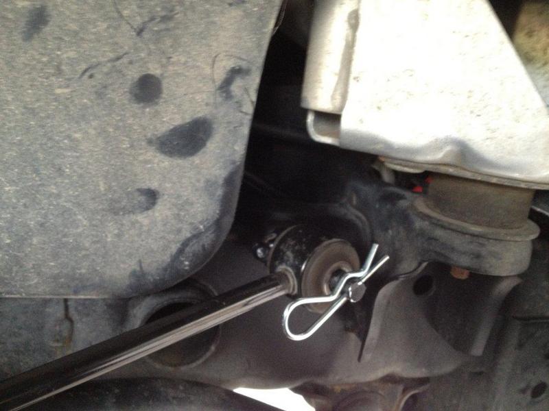

Here are some photos of the sway bar when disconnected and pinned out of the way:
ID:	320066Click image for larger version
ID:	320067Click image for larger version
I just used hair pin cotter pins, clevis pins (2/5" x 7/16) and washers.
Hope this helps.

Are those pins aluminum?

The clevis pins are zinc plated steel.

It helps visualize, yes. I hope that works well for you. I might fear lateral stress on the pins even though I know most of the forces are absorbed in the knuckles. I mean like, there's got to be a reason why we need such large nuts?

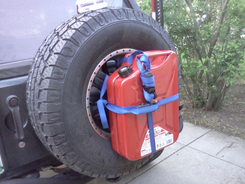

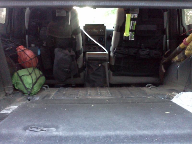

I took the back seat out, rearanged things inside, and strapped up my Gerry can for this weekend

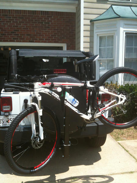

Added a Specialized Rockhopper 29er.
