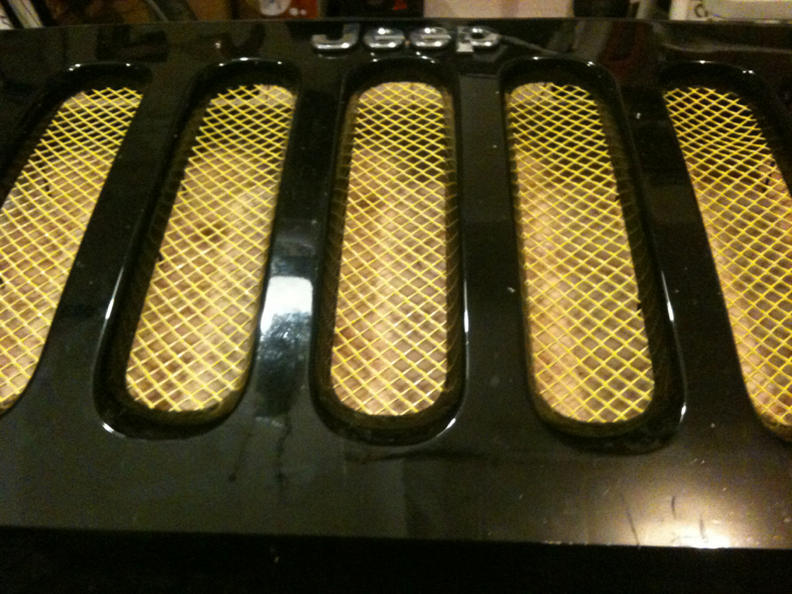

Yesterday I did the "Grill Mod" for the second time in a week and it still didn't stick. The zip tie blocks keep seperating from the tape!!! The tape sticks well to the back of the grill......................Any suggestions any one? Maybe epoxy the blocks down? Today I took off the hard top and doors and put on a new Bikini top!!! First time being doorless................Kinda like it. Leveling kit goes on Thursday!!!!

Scrape the tape off and gorilla glue them, that's what I did.

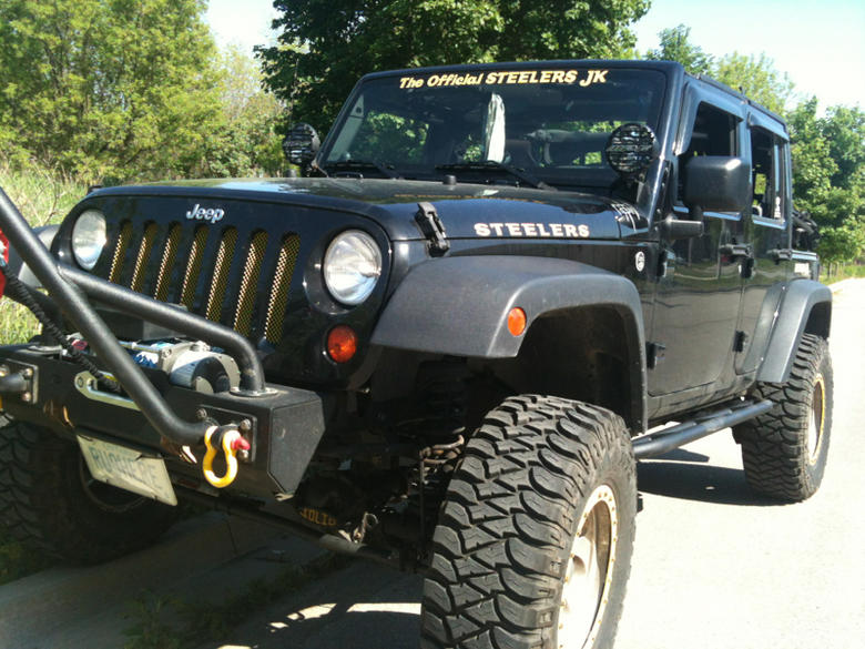

Yeah I scraped all the sticky pads off the back of the zip ties and used epoxy glue for sure... A generous amount too. It's a little harder getting the zip ties thru with the glue oozing everywhere so put them thru first..... I also roughed up the surface on the grill side too for the glue to hold better and let sit over night. And used a second glue(gorilla glue) and dropped some of that on top of the backside of the zip tie blocks overflowing the sides of the blocks a bit for extra security. Didn't look pretty but no one sees that side anyways..... good luck PM me if you need more info.

I did mine with a different material but what I did was take a nut & epoxy them in the grill & just put the bolts in & its super secure
