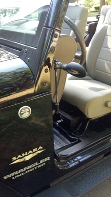

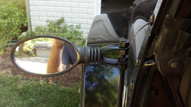

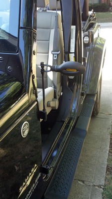

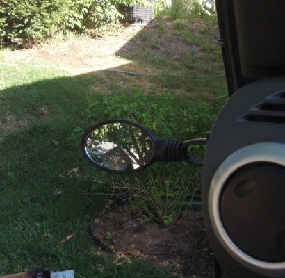

Default Doorless Mirror Mod under $20
I mounted a $15 mountain bike mirror on a 3/8" threaded rod.
Here are pics.

Here is a link to Mirror
http://www.amazon.com/Blackburn-Mult.../dp/B000BNZ0NI

You can see the joint that I removed with Allen Wrench. Simply increased the pre-drilled hole with 5/16th drill bit. Inserted 3/8" threaded rod into the drilled holes. Used 4 nuts at the top and 2 in the door hinge hole. This mirror is specifically designed for mountain biking so it does not move at highway speeds or on heavy bumps. Had it at 70mph and it didn't move. Works very well.

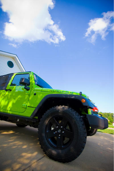

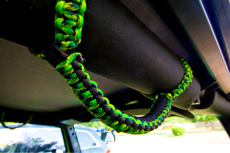

Finally got my rims back from the powder coating shop and finished up the grab handles. Woo hoo! Just glad to be able to go for a drive again even though it's too damn hot.

Very cool JK! I'm one of the few that loves the color of ur rig. Wish mine were the same. And those grab handle are very nice. U should make and sell. I'd buy.

Great grab handles. Was it long to make? Would you make some for other jeep and sell??

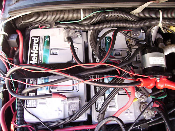

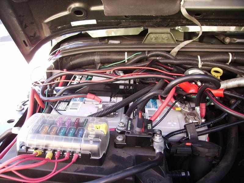

Finally installed my dual batt tray and Diehard Platinums

Added pics

Still have to tidy it up.
