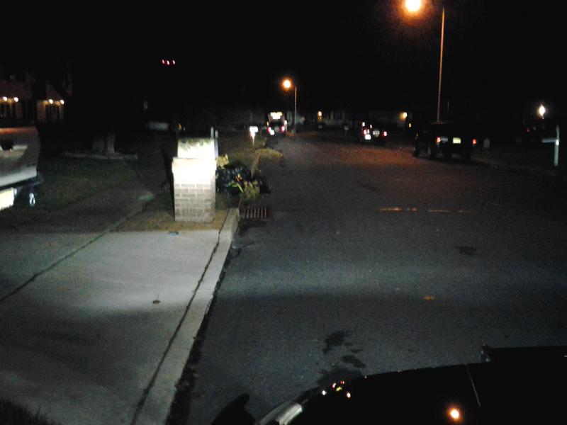

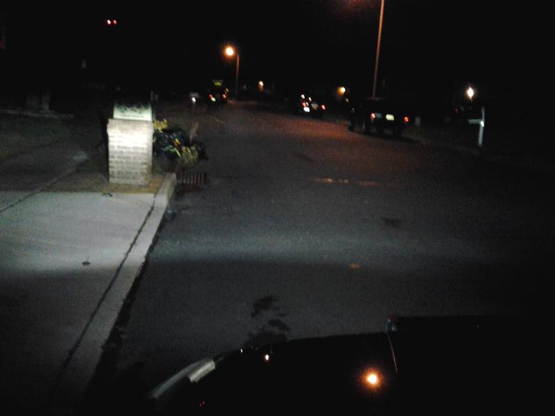

Here's my trucklite headlights.... They are worth EVERY PENNY! The light is just so crisp and clear.... U can see EVERYTHING!
Just Low beams (fog lights off)

Just hi beams (fog lights off)

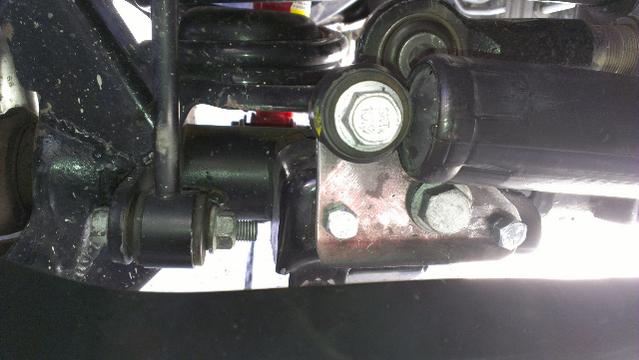

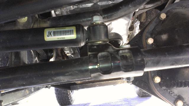

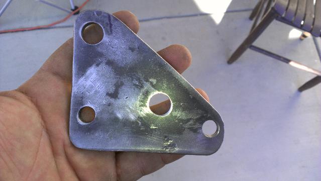

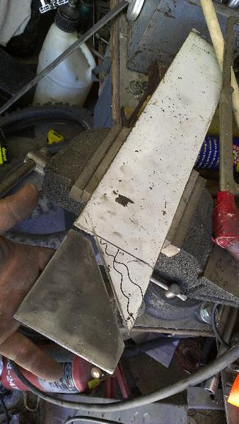

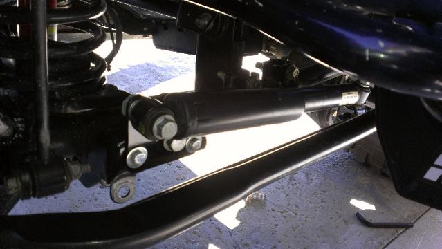

I made a steering stabilizer relocation bracket.
I cut out the piece from 3/16" steel plate
Made a template out of cardboard for the holes to be drilled
Test fitted it
Rotated the clamp that's on the tie rod so the stabilizer is directly above the tierod
Painted bracket and installed. As u can see the stabilizer is up higher and out of harms way. I have flexed it out with both the right and left tire fully stuffed and the stabilizer and the bracket doesn't come in contact with anything and so far I haven't had any problems with it. I still have to cut off the factory bracket but I have been busy installing evo rockstars, shocks, swapping out my tf 2.5 front springs for 2.5 rk springs.
Beautiful.
I did the same (almost).
Great job.
Old Nov 14, 2012 | 08:39 AM
  #26779
bob-o's Avatar
Posts: 2,215
From: rosamond, ca
Beautiful.
Great job.
Thanks a lot. It's fun making Ur own creations and saves a bunch of $$$. Someone sells a bracket just like the one I made and its around $50 bucks

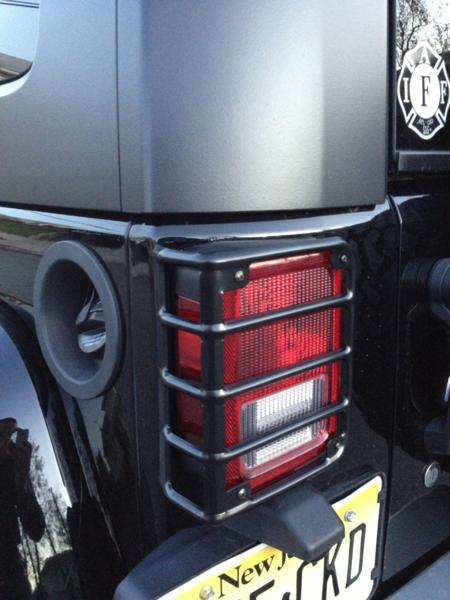

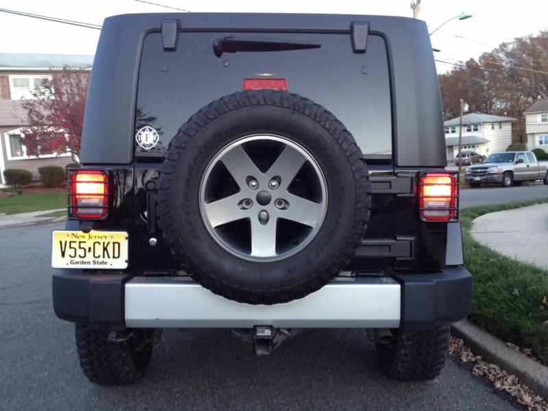

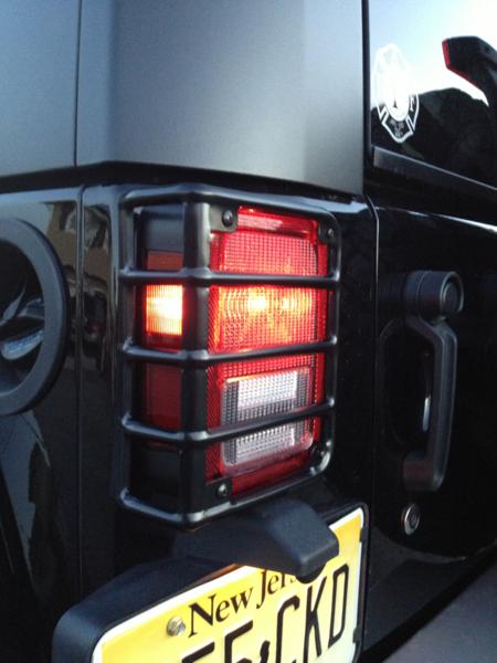

Blacked out the front corner lights. Did the front turn single a while back. Oh and got my rugged ridge euro tail light covers. Good day.
