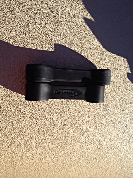

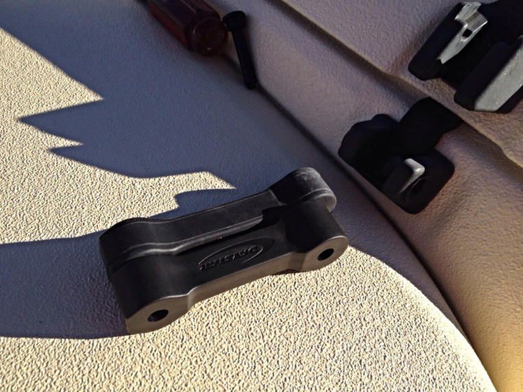

New Daystar hood rubbers so the hood will stop flapping In high winds on the highway.

How difficult was the install on those? Also, is your entire rig bedlined?
Under 15 minutes. Instead of following the directions I took a pair of side cutters and cut the old pins off and left the latch attached. Then just put the new pins in and good to go. They are very very tight. Takes a lot of effort to close them. Keeps the hood very tight.
Yes I have my whole jeep Line-X'ed. Desert tan body and Line-X'ed the top black.
