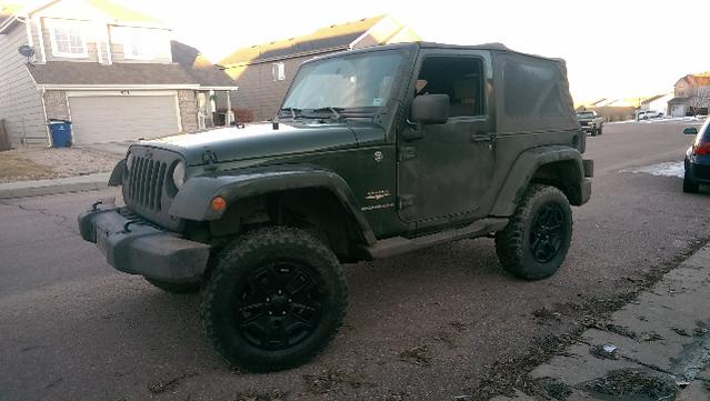

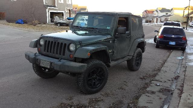

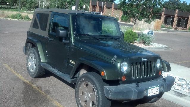

Added a 3" sus lift and new wheels and tires!

Looks good! Welocome.

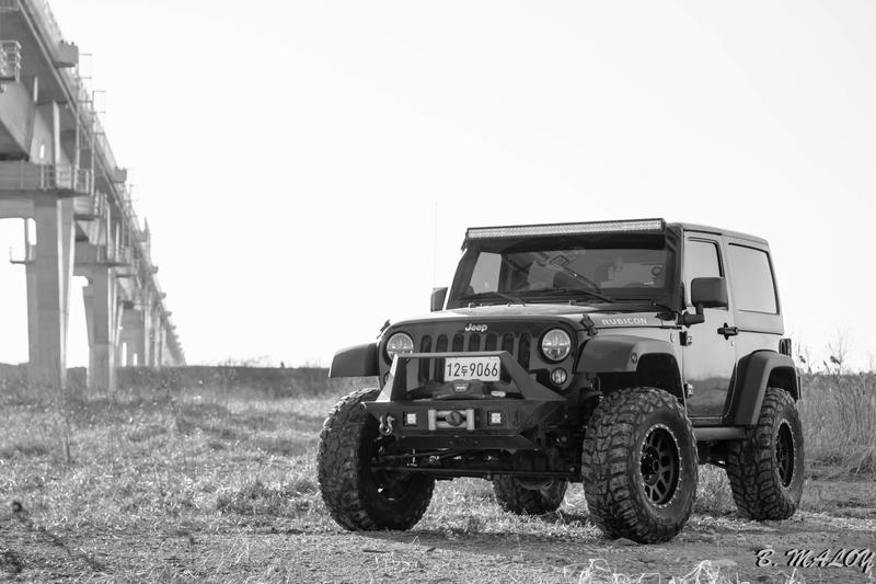

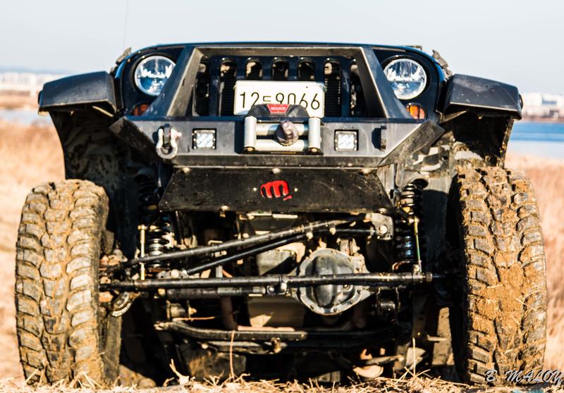

Default RK 2.5 Stock Mod with RRD 2.0 resi shocks
Installed my first lift today with the help of some friends at the auto shop here on the base. Install went pretty smooth, taking around 5 hours. Installed the RK 2.5 Stock Mod with RK RRD 2.0 resi shocks all around and RK 3in bump stops front and rear. Also installed RK rear trac bar and rear sway bar links.
Went with some Method Race Wheels, Mesh 17x9 4.5 backspacing wrapped with some Kumho Road Venture MTs(35x12.5x17).
I am very happy with the way the install went and the ride of the lift shock combo.

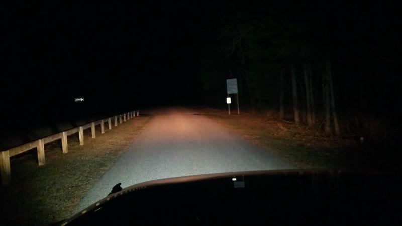

Installed my JW Speaker Evo 2 that I ordered DECEMBER 1st, but just received yesterday.
First the install. I removed the stock headlights and installed the SMS harness. The SMS harness length is sized perfectly. The only issue I had was the connector that plugs into the passenger stock headlight harness needed its locking tab trimmed about 0.050". otherwise it works perfectly. I installed the horizontal adjustment screws. That part was actually pretty easy. I used a small adjustable wrench to unscrew the studs. The trickey part is getting the stud out of the housing. After I installed the headlights losing one of the screws so right now there is a white one in there lol. Drove to a really dark roadway (actually a park entrance) and aligned them. They made me really nervous before aligning them horizontally as there were rectangular blocks and weird aberrations, but after alignment and merging the blocks the light looks much more uniform.
The light output is so much better than stock. I have inspired engineering fog lights in flood pattern and the JWs wash them out except for higher up. I really like the spread of the lights and with my fogs there is no real area unlight. Lastly the highbeams are friggin bright.
