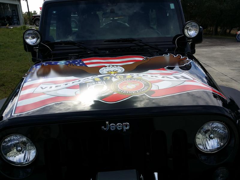

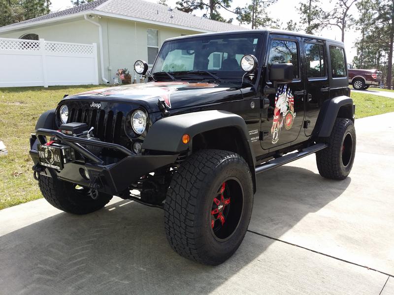

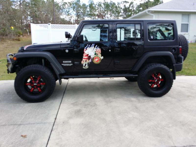

Had a 4" ROUGH COUNTRY SUSPENSION LIFT INSTALLED AND ADDED NITTO TERRA GRAPPLERS 35X12.50X18.THE WEEK BEFORE I INSTALLED THE RAMPAGE RECOVERY FRONT BUMPER WITH A BADLAND 12,000 LBS WINCH.IT'S A WORK IN PROGRESS.

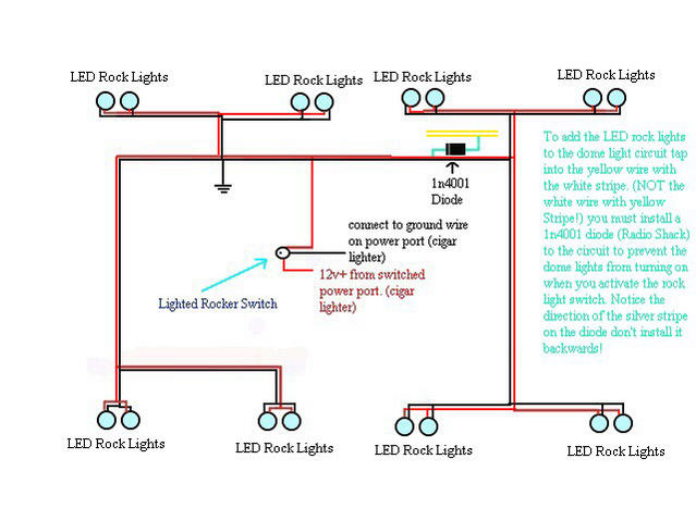

How to wire to a switch and to dome lights? I know the yellow wire with white tracer is for them to come on with domes. I'd like to be able o switch them on as needed too.

Getting a motoboner from your jeep.

You can use a 3 way switch.
With relay.
Without relay.

Since I have an Spod I am using it to switch the lights. For use with dome circuit I'm tying in to dome wire next to rear passenger seat and tying in to my hot wiring to rock lights using a diode to prevent power to dome when using switch.
Here is a diagram I've seen (sorry don't remember who posted it)

Thanks!
