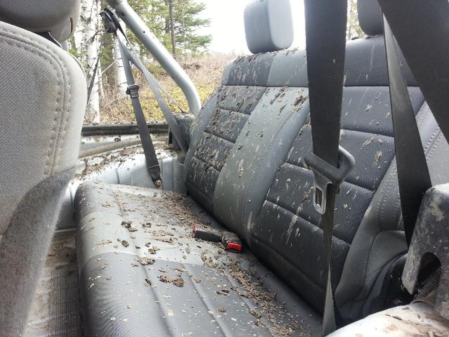

Its a rear seat from a 2007 2dr and i made brackets out of aluminum but i would suggest teraflex ones.
Not that much room..

Seat belts i am currently using the 2drs but am swapping too just waist ones.

Its a rear seat from a 2007 2dr and i made brackets out of aluminum but i would suggest teraflex ones. Not that much room.. <img src="https://www.jk-forum.com/forums/attachment.php?attachmentid=603997"/> <img src="https://www.jk-forum.com/forums/attachment.php?attachmentid=603996"/> Seat belts i am currently using the 2drs but am swapping too just waist ones.
assuming you just fold the third row forward when you're going to put the soft top on?

Yes just slide i5 ahead a bit. Fits nice.

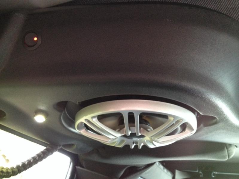

Installed reading lights for the kids with separate switch(red light upper left). Wired to the dome, so that they only work with keys in and turned to on. The position is perfect for them and for the driver, you do not even notice they are on in your rear view mirror. They were just some "bolt LED lights" I found on Amazon.
Light off:
Light on:
Also, replaced the speakers in the sound bar with Polk Audio DB651 speakers. I also packed the sound bar with Poly-fill. Major world of difference. I found out after the fact that the DB651S (Note the "S" at the end), was the proper speaker to use so that you can use the factory grill. I'll be messing around to see if I can cut out the tweeter in the grill and get the factory grill to still work, and order the proper ones for my Wife's JKU.
