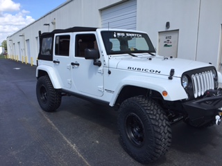

Installed JKS 3.5" JPEC Konnect with Jaxis upper control arms and 35" Nitto Trail Grapplers with Fuel Anza wheels

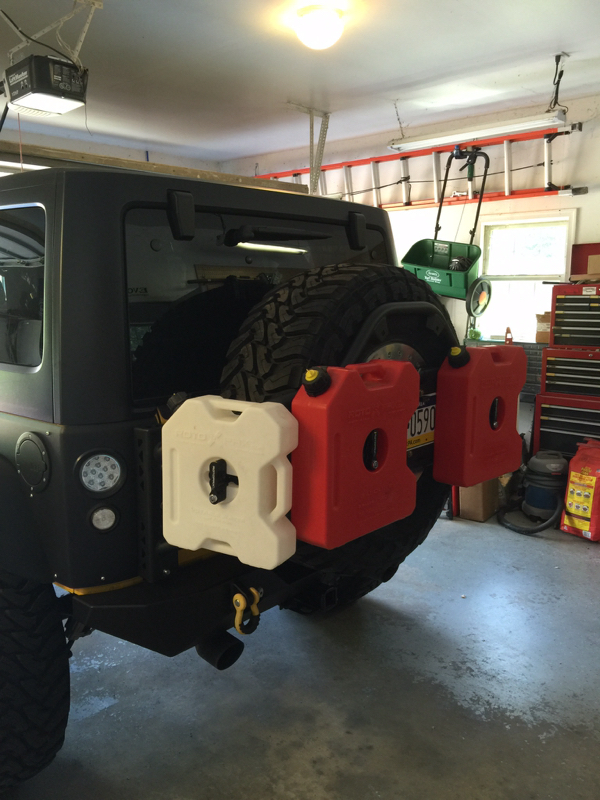

Got my Rotopax mounted a week or so ago. Click image for larger version

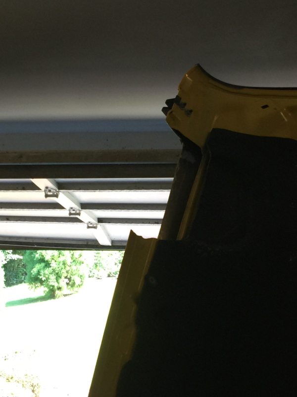

Looks great! Got any pics of the install itself? Curious how the snorkel body attaches to the A-pillar.

I think you rig really looks nice. Are you running 16" wheels?

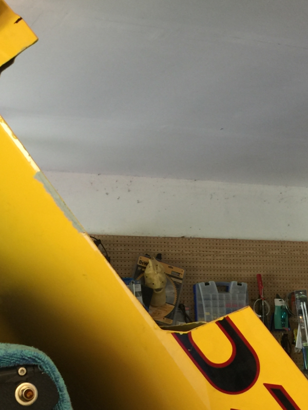

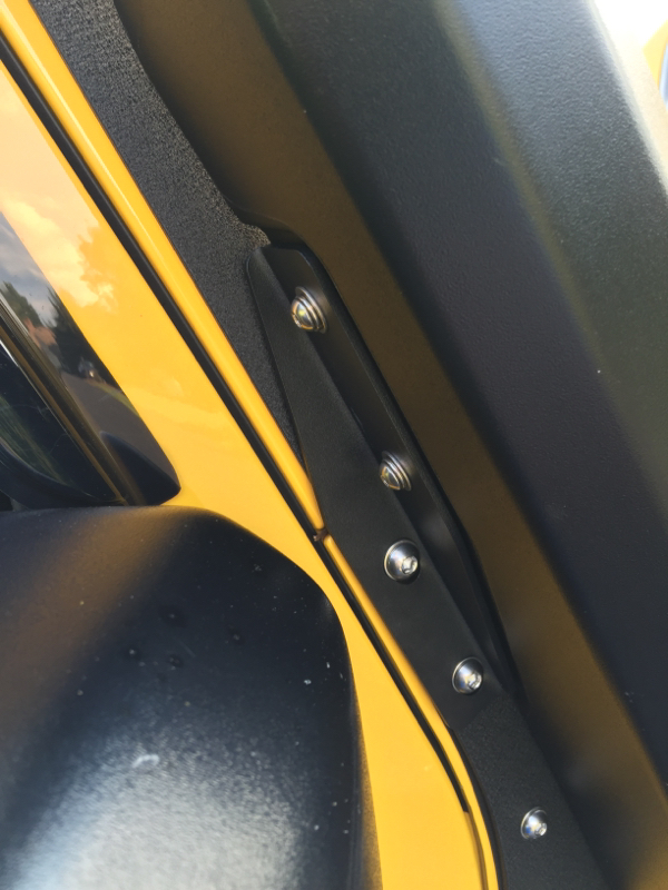

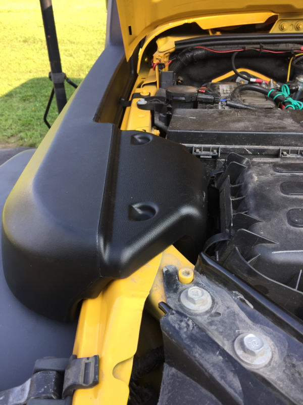

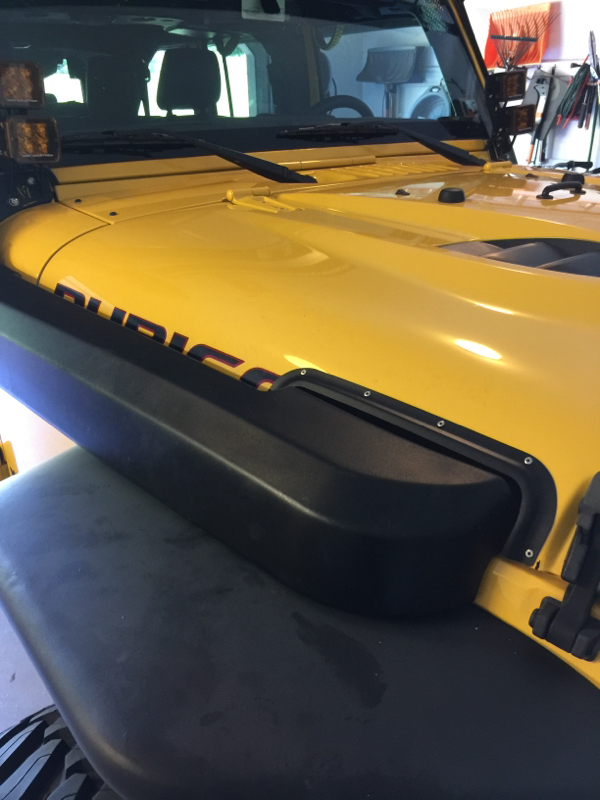

Thanks! It's a pretty easy install to be honest. I've cut so many hole in my jeep already that cutting the hood was a non-issue. Just follow the directions. Here's some pics. Click image for larger version

Sorry. Stupid iPhone!
You just put the brackets on the snorkel. The brackets mount to existing bolts under your hood & on the a-pillar. (You'll see in the pics.) Just do that first along with attaching the snorkel to factory air box & siliconing the joint & holes let cure while you cut & prime the hood. ( I just hung the snorkel over a large outdoor garbage can after connecting to the Air Box & siliconing to let it cure.) It took me 2.5 hrs from start to finish.
