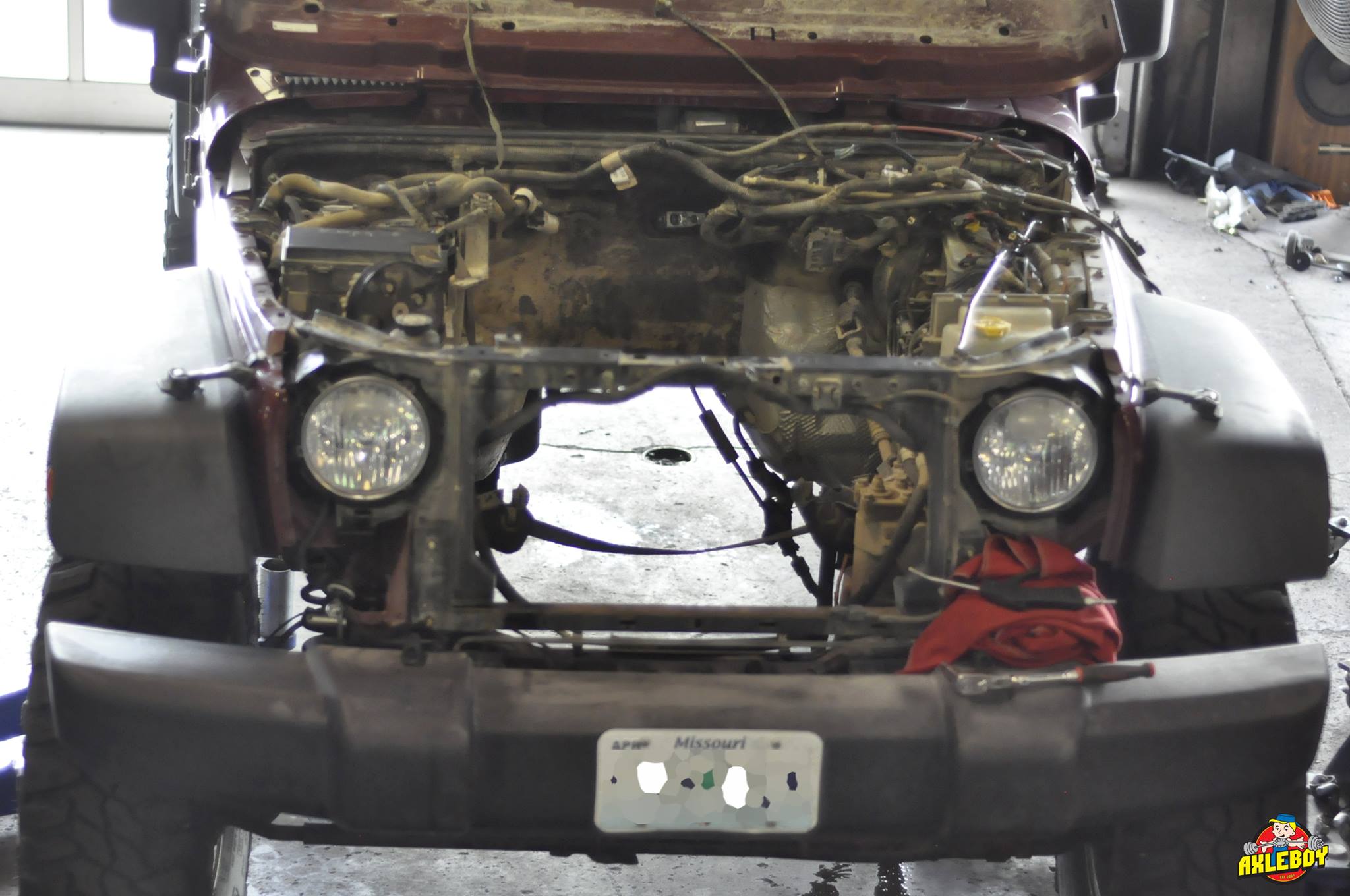

New Jasper 3.8L (rings) and rebuilt NSG370 that was popping out of gear.
New catalytic converters too.
My 2008 is like new now.

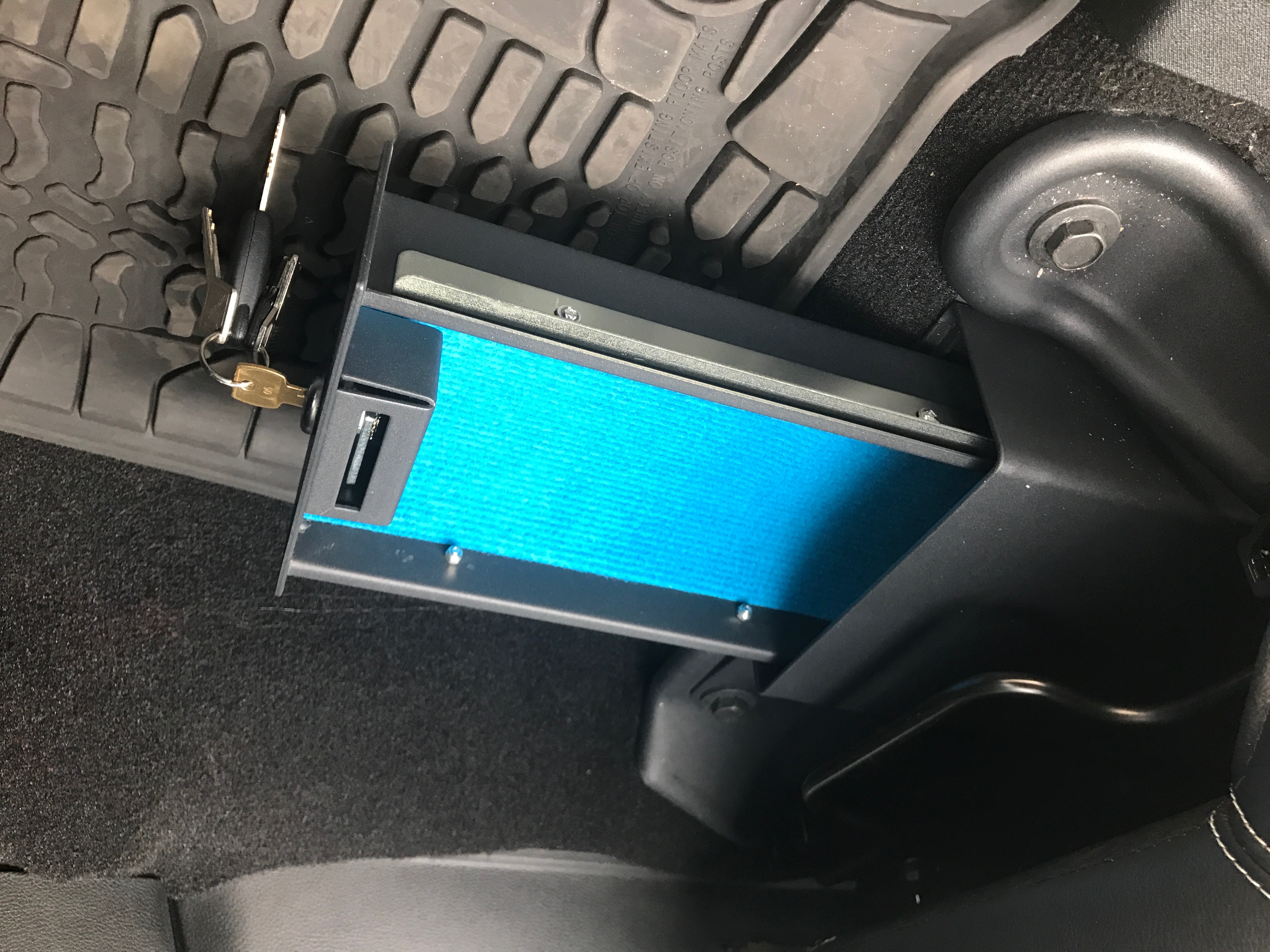

Several minor mods this week. The one that'll be put to use most frequently is the Bestop under-seat lockbox. Super-easy install. Finally, a place to lock away the valuables when the top & doors are off! Nice spot for the S&W too.

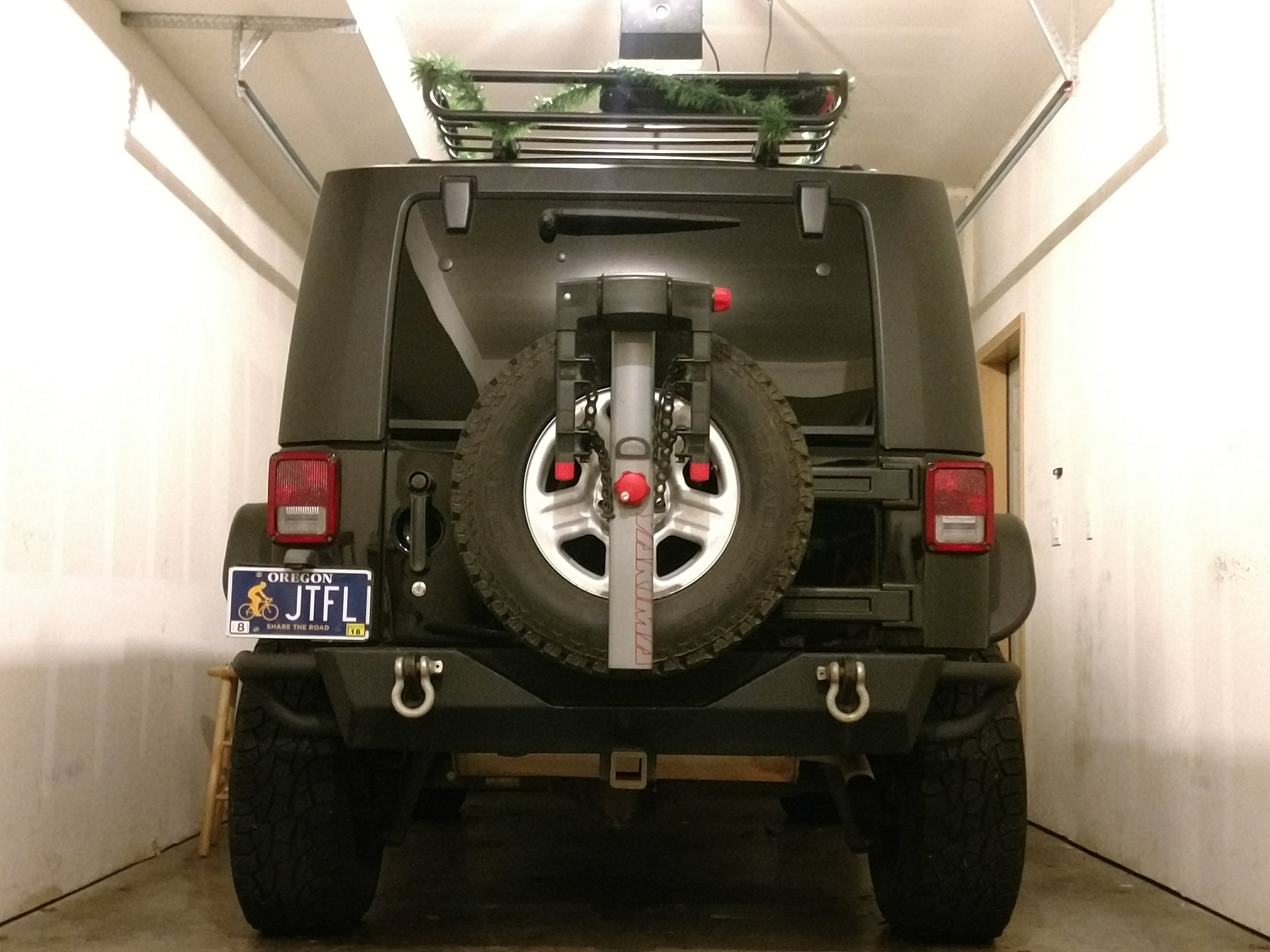

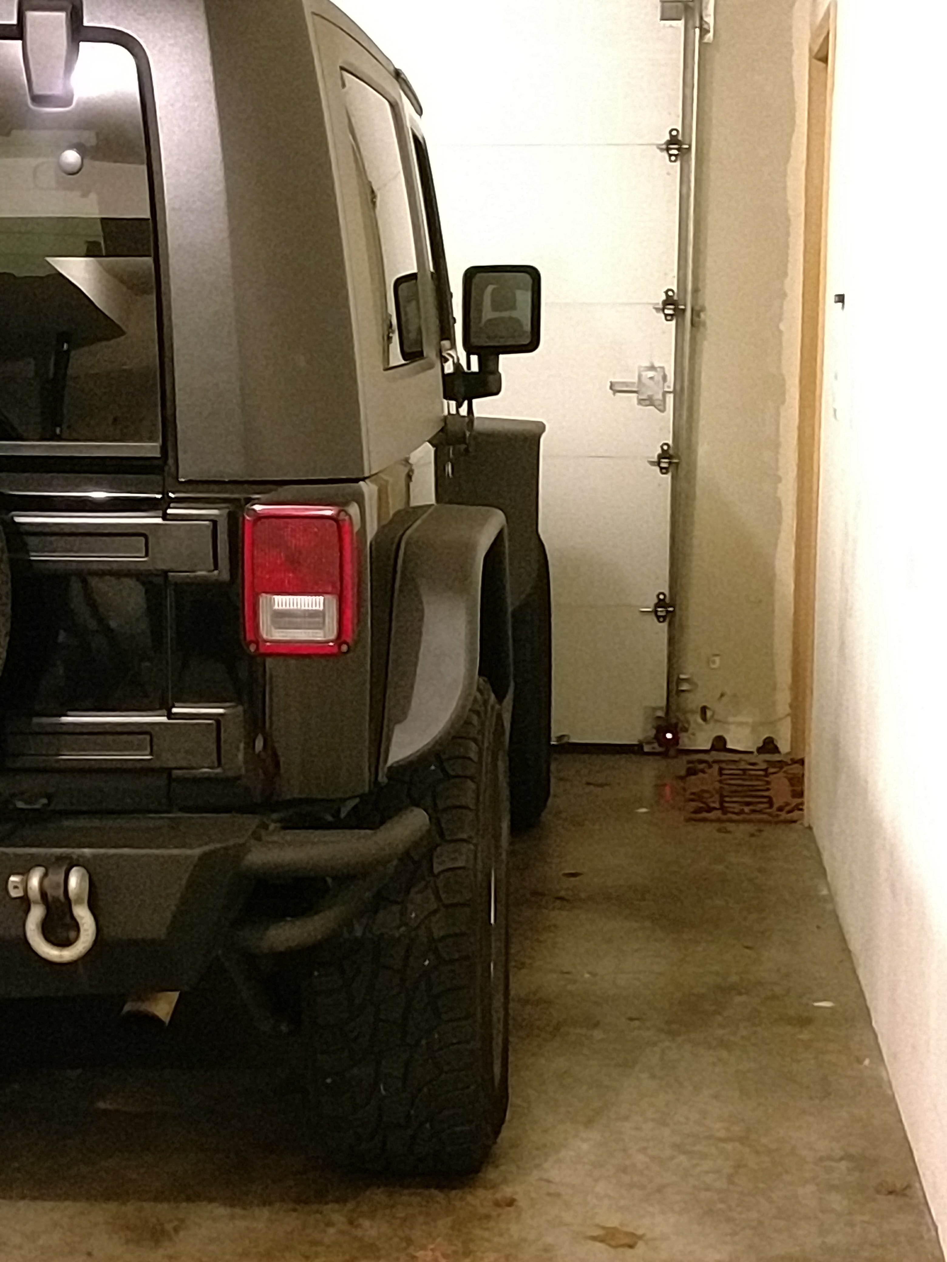

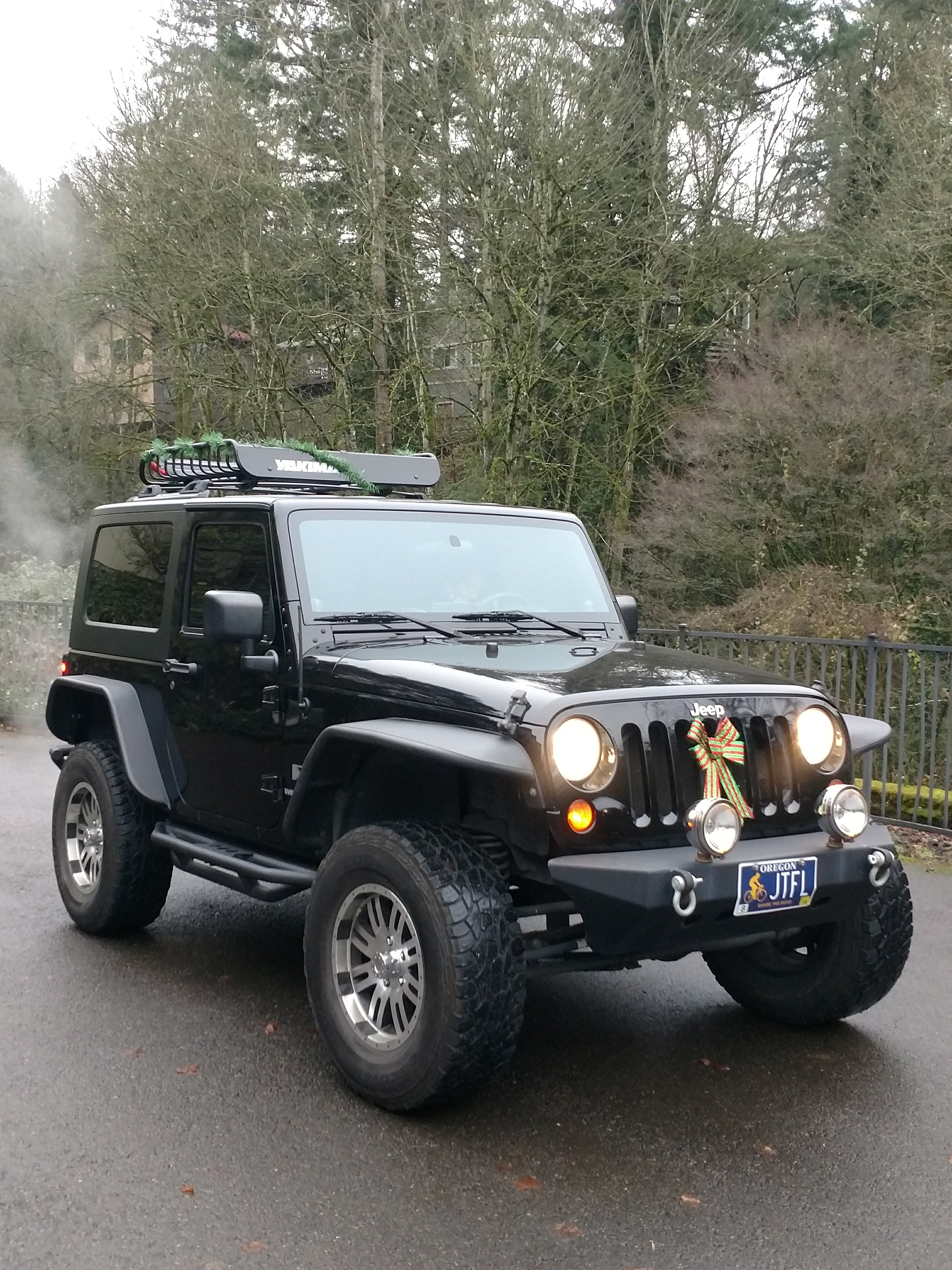

Finally got around to grinding the flanges on the rear fender flares from Black Mountain and installed them this weekend. Kind of a PITA, but just glad that I was able to finally replace the old faded plastic fenders. Also cleaned up rust spot on rear bumper and sprayed with Rustoleum textured black finish to match the powder coat. Now I just need to get those rims replaced!

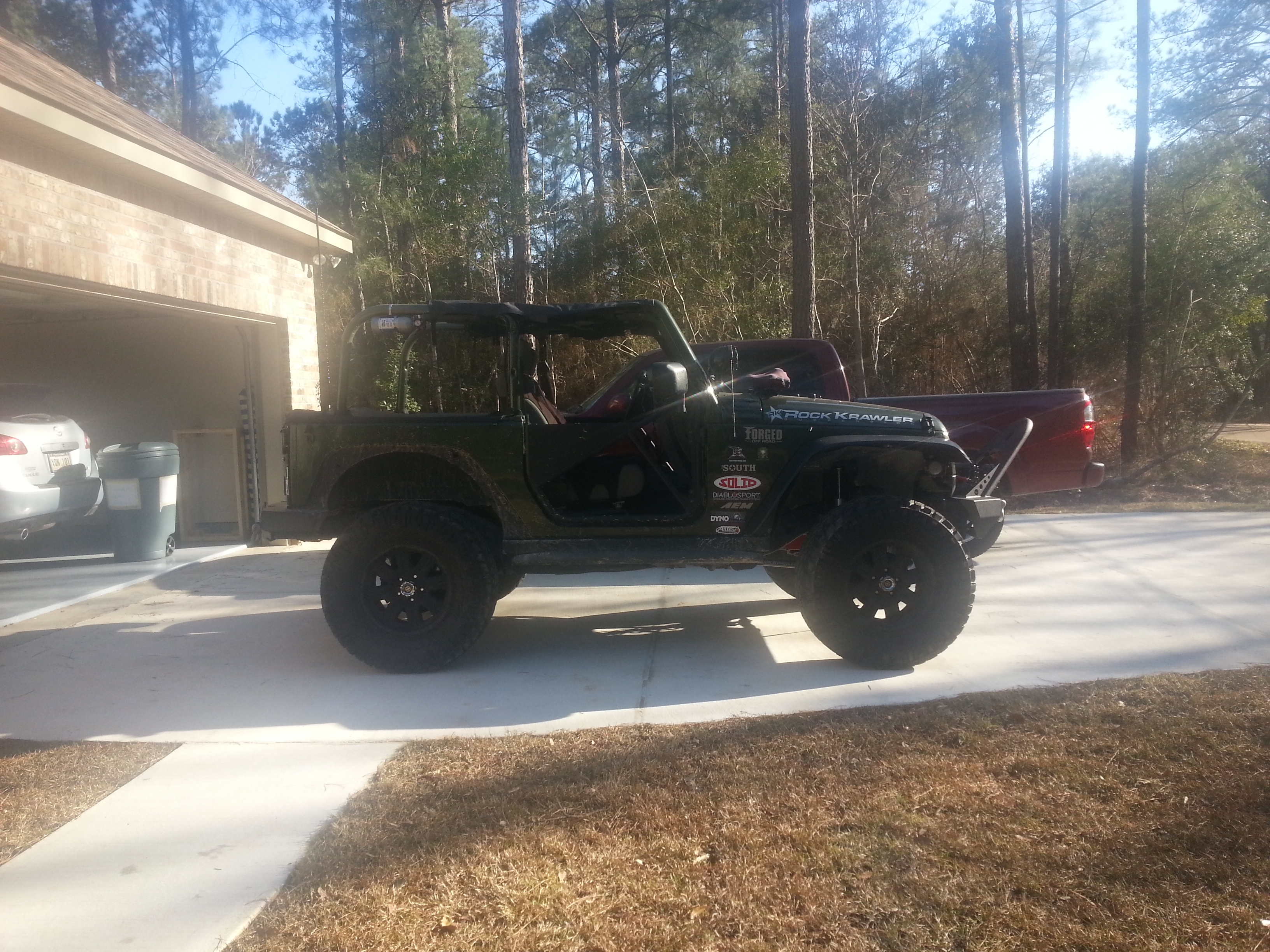

You can always bedline your rims if you like the style. I did that to mine years back and they hold up great off-road and super easy to touch up with rock rash. Rims used to be black chrome until I got into rock crawling.
Sanded them down with a wire wheel on a drill. 2 coats of self etching primer and then 3 coats of bedliner. Didn't even have to unmount the tires from the rims. Used a deck of cards between the rim and tire and sprayed the rims on the grass outside my garage. Took 1 weekend to do all and put back on the jeep. Definitely saved some coin for other upgrades.

Thanks for the recommendation. I've considered that as well, but I don't really like the backspacing or style of the wheels. They came with the Jeep and I've been looking to upgrade them to 17x8.5s with a little more backspacing than these wheels. But might be something I need to consider if I'm able to save the cash.
