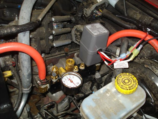

Installed a York 206 OBA setup in the JK. Got the 206 for $30 from my friend who loves collecting parts from older AMC/Jeep. Used Off Road Only's bracket kit and Woods/JeepSwag air manifold. Check valve and oil separator from Grainger. 5 gallon air tank reserve from Sears. Used a 5,000 PSI hydraulic hose as the output form the compressor (gets VERY hot VERY fast). Steel braided, holds the pressure and heat MINT. The rest is 3/8" 300 PSI line. Run 150 PSI pressure switch. Airs the 5 gallon tank in 2:18. Airs a 35" MT/R from 9 PSI to 28 PSI in 1:32 on idle. Run my 1/2" impact with no issues and plenty of reserve on the tank for all 5 lugs. Trail repairs will be MUCH faster now. Removed the head cover and drilled/tapped for 3/8" NPT. Created and welded my own brackets for the check valve and oil separator.
I don't care what anyone says, belt driven compressors are the way to go. I've had ARB electrics, Harbor Friehgt electrics, they are NO comparison.
Total cost was $490 vs. $1,100-$1,200 from Kilby/ORO. If you can make things yourself...do it.
Nice freakin job ! Would have liked to have seen a write-upon this.

Well the ORO bracket kit is pretty straight forward (comes with instructions). Practically comes with the bracket kit, new idler pulley and new serpentine belt. You relocate the OEM idler to the emboss that's already on the block. It uses a bolt that you need to remove from the motor mount to frame bushing. The new idler gets installed where the OEM one used to be.
Ran from the compressor to the oil separator.
Oil separator to the check valve.
Check valve to the air manifold.
Air manifold to the air tank.
No chuck at the air tank, it's only a reserve.
Wiring is straight forward with Viair's pressure switch. One lead get's connected to a fused power source (ie. 30A inline from battery). One get's the switch leg from a toggle (the one you see at the bracket I made). One is ground. One is load to the compressor's clutch.
I bought the 6 groove serpentine clutch form Ryder fleet services online (the truck company). $85 vs. $150 from Kilby.
Parts used:
Grainger check valve 5X781
Grainger oil removal filter 4RA16
Ryder 6 groove serpentine clutch Airsource MEI 5030
ORO JK York bracket kit
York 206 (or 210, going to upgrade to a 210 once I find one +4CFM higher than the 206, 6 vs. 10 CFM)
JeepSwag/Woods air manifold
Viair 110 on/150 off pressure switch
Grainger 165 PSI safety valve 5A714
The hose it at your disposal. I ran 3/8" airline from Lowes and the output hydraulic hose looked like 1/2" OD 3/8" ID 5,000 PSI hydraulic hose (had some laying around). This DEFINITELY needs to be a high temp./high PSI hose. The rest can be normal air line. Though, the airline from Lowes seems to bulge a bit more than I like, so, I might get some more 3/8" black Goodyear made in USA air line from Harbor Freight and chop it up to use as the system line. I use that line as my air line for the air tools and it doesn't bulge up at all at 150 PSI.
