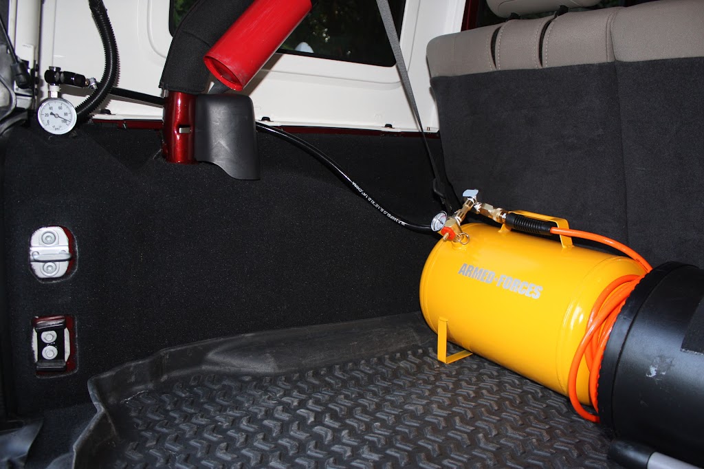

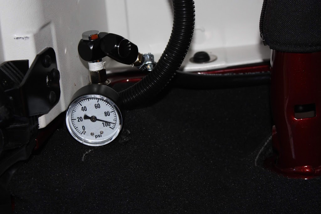

I've been debating about adding a permanent tank to my onboard air system. (I previously relocated my air outlet to the rear cabin). I'd like the spare capacity to help speed up airing times, but didn't want my compressor to always have to fill an entire tank every time I turned the system on. Ended up going a bit of a different route. Purchased a 5 gallon tank from Harbor freight ($19.99 - 20% off). Cut off the tire chuck and added a quick release and a splitter to attach a hose. Now, I can quickly tie into my onboard system. Should speed up airing tires, and will reduce the amount of cycling while engaging lockers. Added a strip of velcro to the back of the tank so that it holds tight to the rear seat. A quick release and I can take it out of the Jeep... Or just disconnect the hose so that the tank is bypassed.
From 0 PSI, it takes my ARB compressor 2:35 to fill the 5 gallon tank to 90 PSI.
Can take it out easily and plug into my garage Air Compressor to expand my capacity there as well.
Damn fine work!!!!!

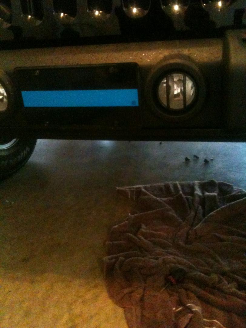

Put a license plate on the front and some fog light guards.
