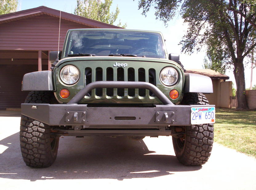

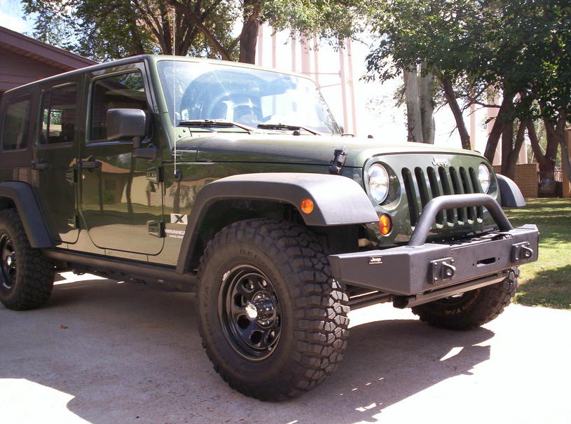

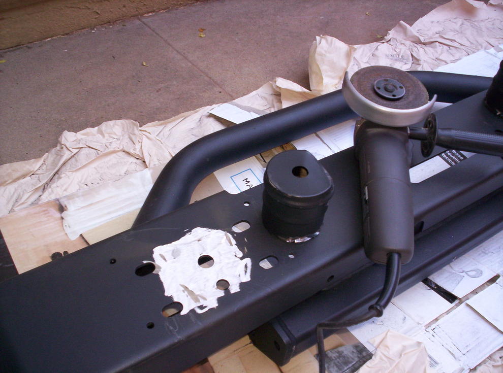

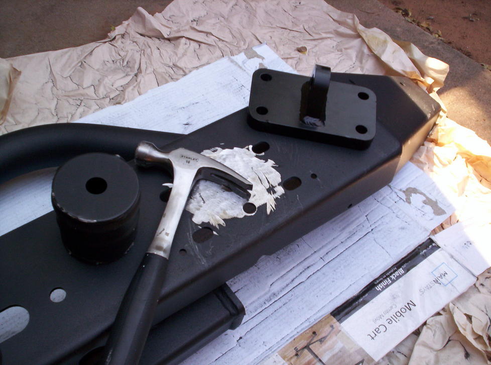

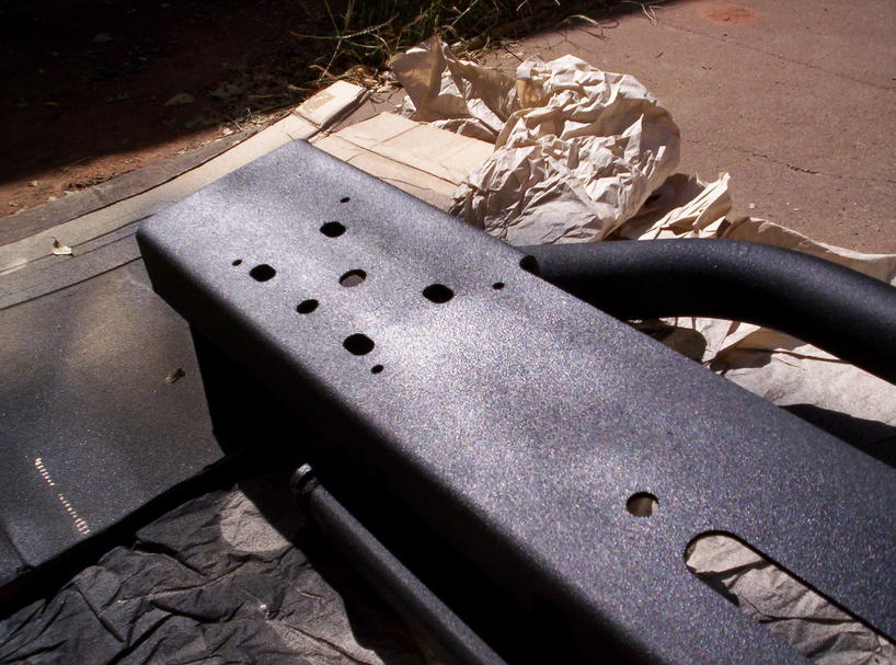

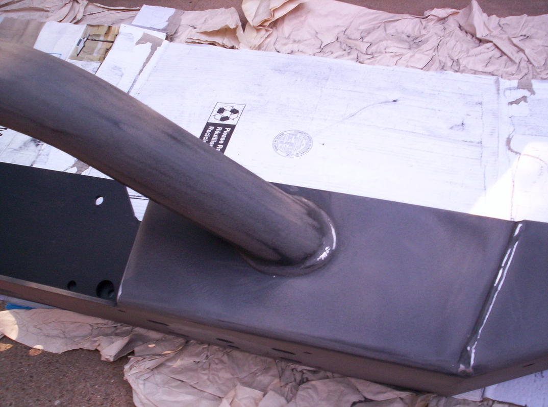

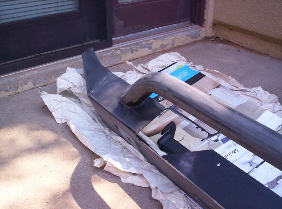

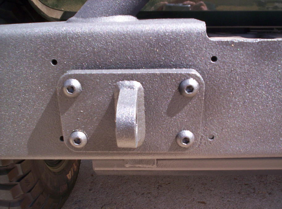

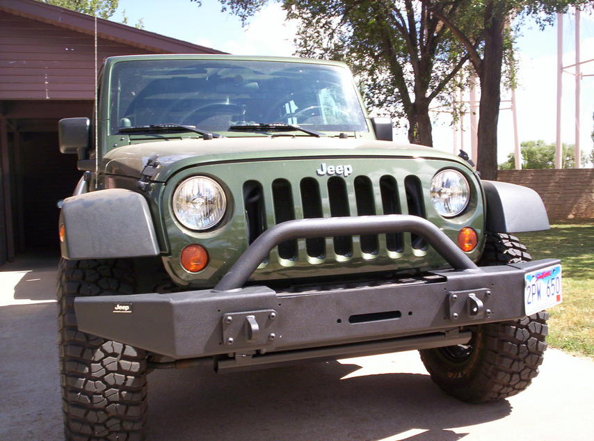

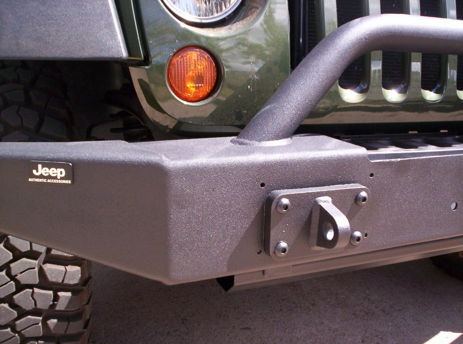

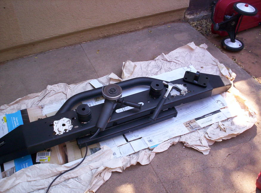

Finally got PJ shackel mounts in. Cut off crush cans from mopar bumper. Grinded, Sanded, Painted, and mounted bumper. Used Duplicolor Bed liner. Finish is much better then I hoped for. Next weekend (fingers crossed) install my 4 inch rough country x series lift, and paint rubi sliders.
