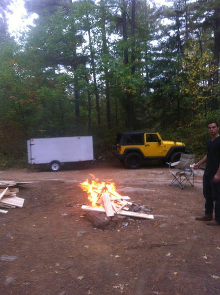

I've never gone cross country towing, but back when I had stock gearing (08 2dr x with 35" tires) I towed a trailer all the time for trips of 5+ hours... Never had a problem.
The jeep handled fine, however the long up-hill stretches would take a lot of work.
Not sure if any of this helps, but that's my input
