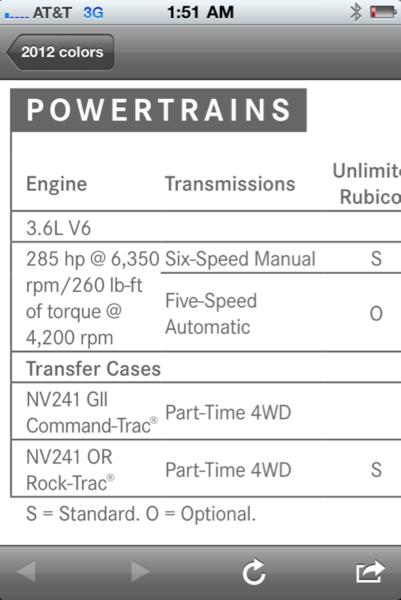

I'm all for the new motor and more horse power but at what cost? REDLINE!!!!
Does anyone see an issue with the horse power specs.... Look at the RPMs it takes to make the 285HP
I don't know about you guys but I shift well before 6000 RPMs.

Thats fine, but is it making more or less than we currently are making at our shifting speeds, I would assume it is.

Well we know for sure that it makes 208 horsepower at 4200 rpm. The 3.8 peaks at 205hp @ 5200rpm. Also take into consideration that the new motor makes at least 234 ft.lb. of torque starting @ 1600rpm. The 3.8 peaks at 240 ft.lb. @ 4000rpm.
Gives you an idea of the power characteristics of the two. The Pentastar out grunts the 3.8 by a fair amount down low and blows it away under hard acceleration.

Yep, the issue I see is that you are cherry picking the highs, not the averages, nor are you comparing the curves.
Area under the torque curve is what's important for our jeeps (and the proper gearing to take advantage of it), not individual points on the curve.

Horsepower makes for great advertising, but torque is what moves you. The new engine makes more torque and lower down in the rpm range.
