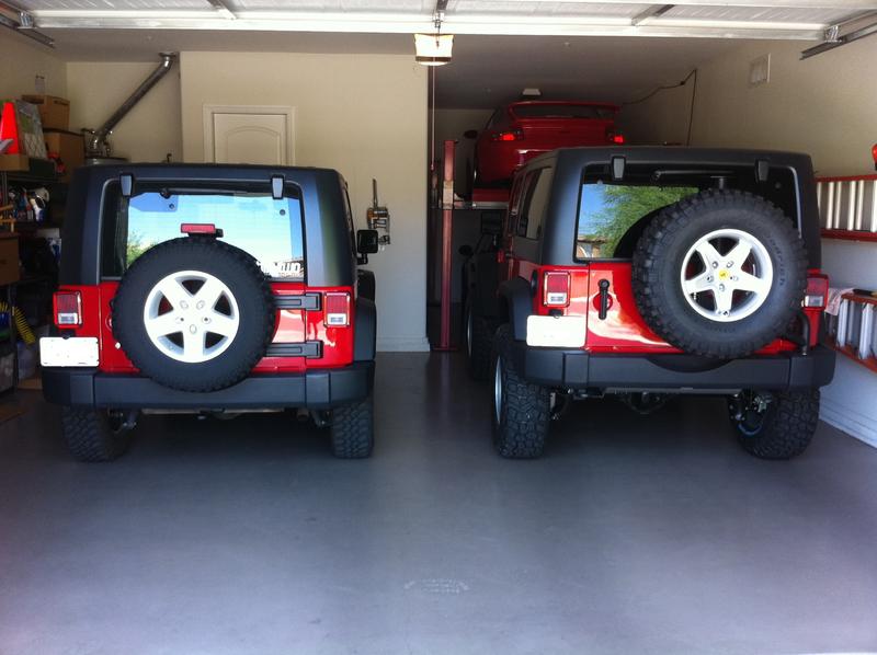

  • AEV 3.5" premium lift kit
  • AEV spare tire carrier on stock bumper
  • Pintlers
  • 35" BFG km2s
  • regear to 4.10 next week

WOW, finally someone else who's fantic about red!!!
Tell me about the car lift and what kind of ceiling height do you have ??
Thanks !

thanks for posting a pic of km2 35's with the aev 3.5. i have a 2.5 bb with 35 km2 and i wanna go to the aev 3.5. it looks nice! thanks for posting!

It's a 7,000 lb capacity Backyard Buddy working with a 120" ceiling height. Since it only has 71.5" of room underneath, I use two 1/2" thick (12" x 12") high density rubber squares under each leg platform. That gets me enough to clear a stock height JK on Rubican tires. But, with the Jeep underneath, nothing else will fit on top - hence the Mini Cooper + 911 combo that lives in the alcove garage bay. Great for changing my own oil - it'll pay for itself in 50 years! Actually the oil change on the Porsche runs ~$300 at the dealer; I can do it myself for about $70 (9 quarts of Mobil 1 + filter).

Dont mean to hi-jack but what did your lift run you if you don't mind me asking?
