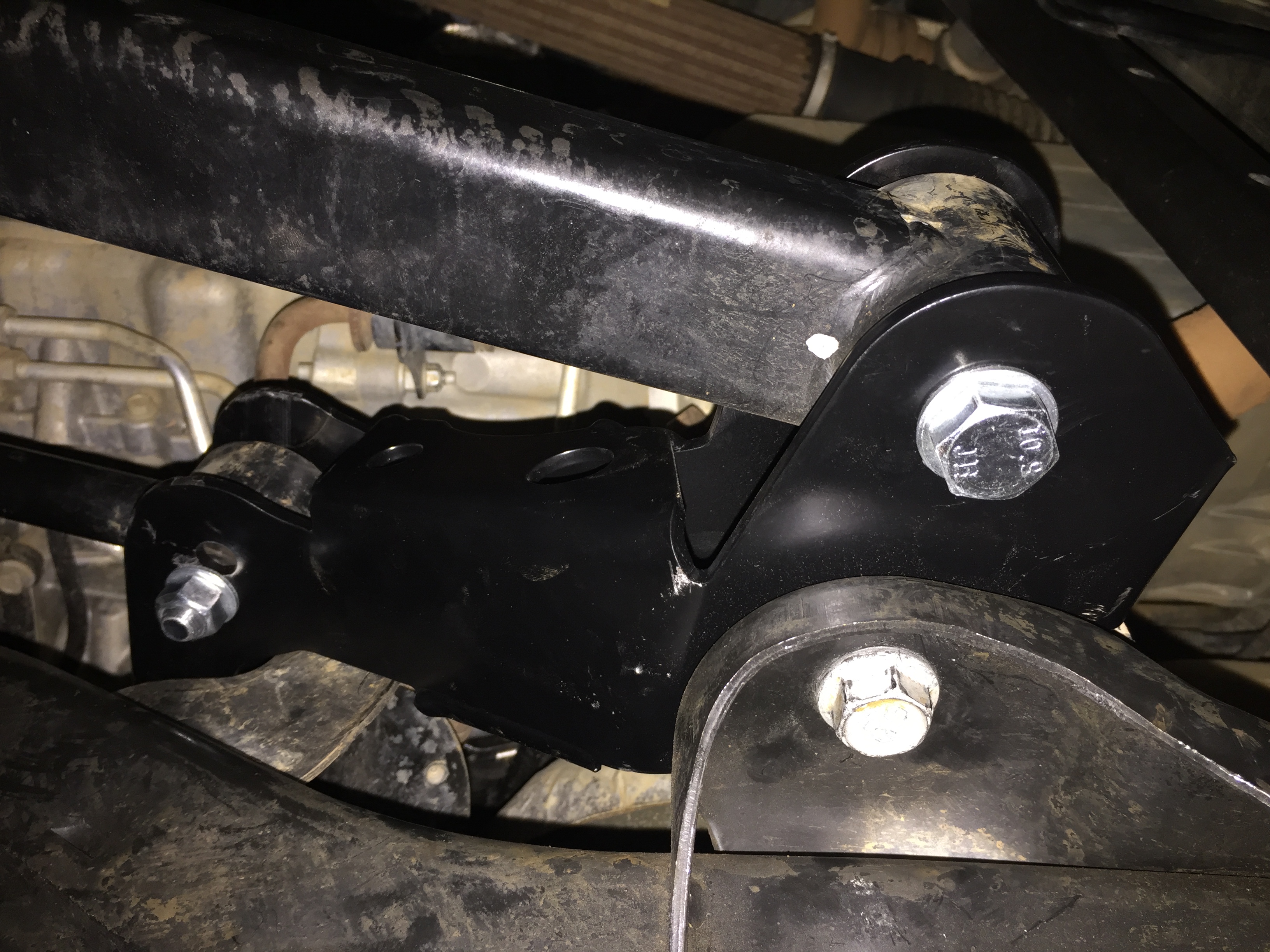

Yesterday I added the JKS Control Arm Drop Brackets and it did wonders for the steering, the wandering is gone. I have not had a chance to jump on the freeway and test it, however, had it to 65 and the steering is good to go. I will have the springs next week.
Here is a pic of the bracket.

The drop brackets are actually better for ride and geometry then adjustable control arms, if you are not needing extreme articulation (12"+) and don't drag the brackets you are not going to get a better ride from going to an adjustable arm like the metal cloak or rock crawler.
