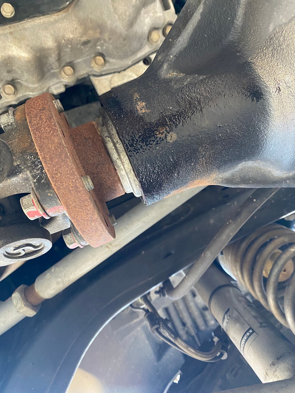

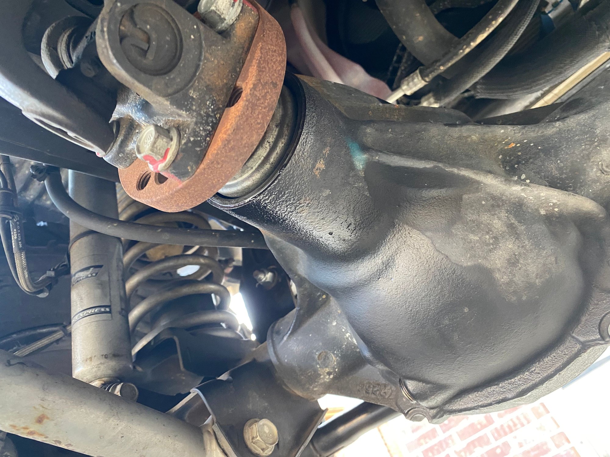

But overall the jeep drives much better now I have more control over the steering with no bump steer or very little. Since you’ve had jeeps longer than I have what are some of the main issues I can look forward to encountering I already see a little bit of I don’t know if it’s oil or transmission fluid Where the driveshaft and transmission meet.

Old Mar 1, 2022 | 10:41 AM

Originally Posted by Harry0912
That sir, is a pretty bad pinion seal leak. Seems worse than what typically see IMO. New pinion seal doesn't cost too much but going to require removing that DS and removing the pinion nut to get the old one out and new one in.
Your earlier description almost sounds like the anitlock braking system kicking in for some reason (pulsating back felt in the pedal) with the traction light kicking on. If that is the case, seems like something is triggering that as it's not normal under regular driving circumstances. Do you have something that reads deeper than basic OBDII codes?
With a lifted jeep and bigger tires, ball joints are something to keep an eye on. There's not a great shot of one in your pictures, but I'm guessing you still have factory BJs. Bad ball joints are a common source of wobble issues on a solid axle vehicle and are definitely something to inspect regularly.

From: Calgary, AB, Canada
... and please remember to put blue loctite on that pinion nut when you retorque the nut. Remember there is a crush sleeve in there that was set at around 140ft/lbs tq so don't go near that setting or you may crush the sleeve a bit more then you have to dismantle the diff and reset the pinion depth and setup the ring gear. I torqued my rear down to 100ft/lbs on my rear diff and it has been good so far with no leaks.
PS I hate crush sleeves and if I ever pull a diff apart I will use a solid sleeve and shims to set pinion depth. Makes the diff so much stronger as engine torque cannot "walk" the pinion away from the ring gear by crushing that sleeve a little more.
