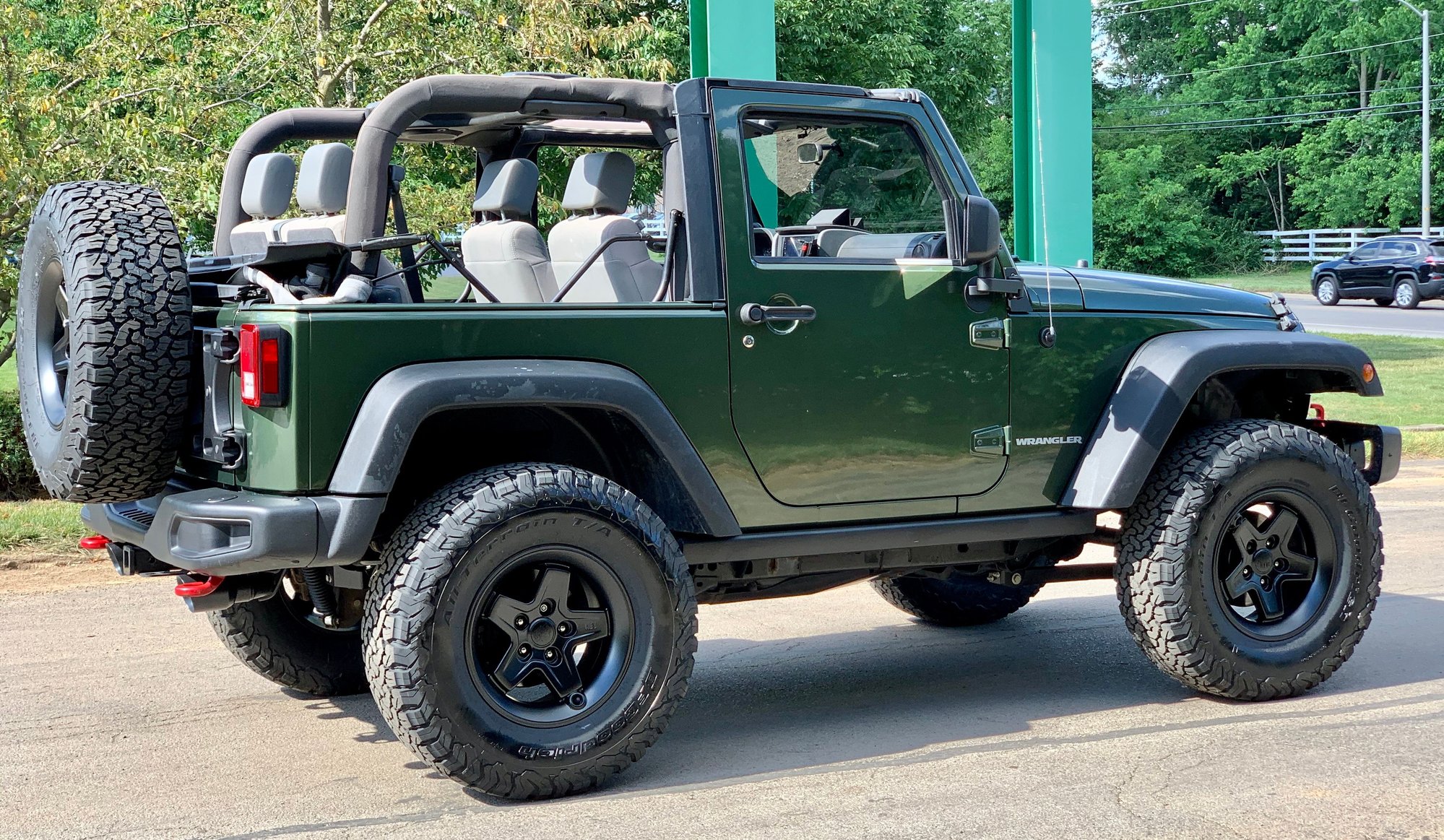

I put the 2.5” AEV Dualsport lift on my JK recently and simply love it. I read so many reviews with folks saying their JKs rode and preformed better than stock with the AEV lift that I that I had high expectations, especially because of the price. So, we put on the AEV lift, Geometry brackets (highly recommend as well) new AEV Pintlers, new 315/70R17 K02s and several other mods and I’m happy to report the Jeep does indeed ride better than stock. It’s a dream off road too and really looks alot better that stock.
