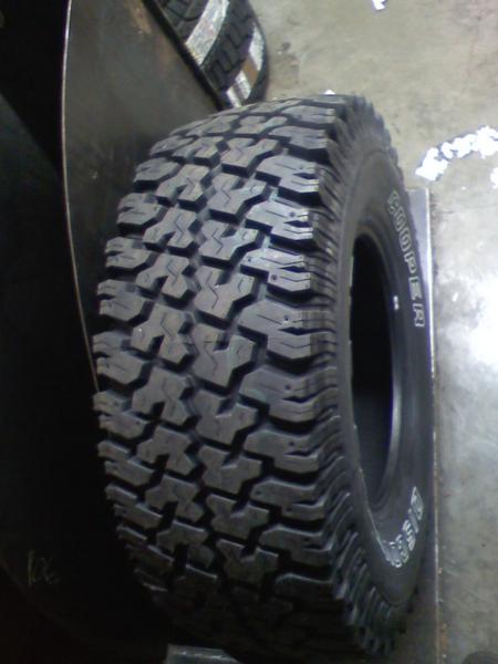

Get some Cooper Discover S/T's you will be glad you did!! Plus made in America! My brother has been in the tire biz for 15 years and he raves about these bad boys!
ID:	100452   Click image for larger version
