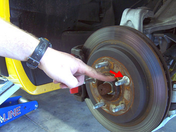

The OP is stating that he feels no vibes, so I HIGHLY doubt there is any tire imballance or he has a bent flange.
I'd put money on the lug retainer clips, like was said at the beginning. Some wheels dont have recessed spots for them and the cause the wheel to mount wrong.
To the OP, take the wheel off and look for these:
<img src="https://www.jk-forum.com/forums/attachment.php?attachmentid=490930"/>
Thanks going to check it out now
