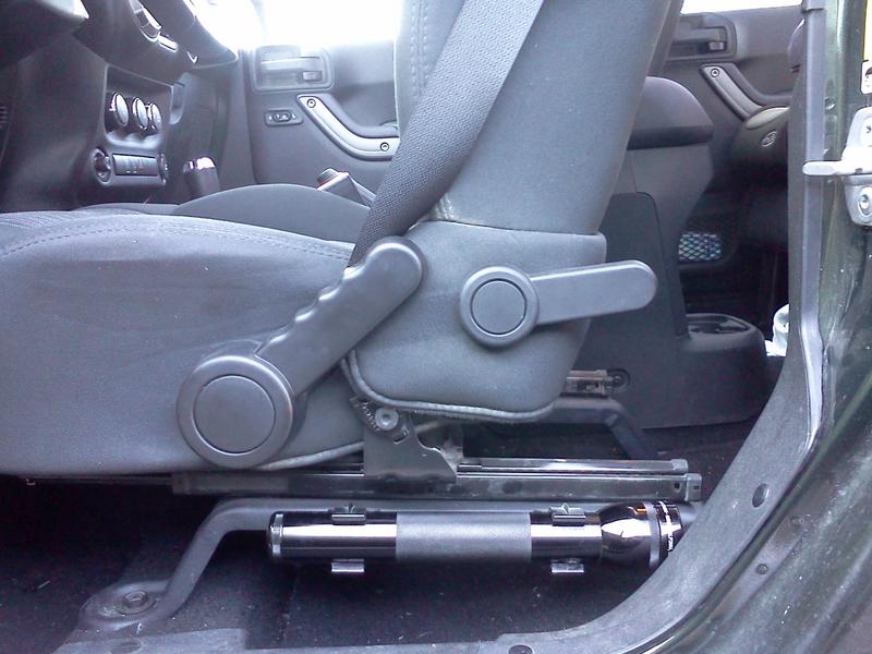

Had the same issue and found someone on here that had moved his so I did the same thing. You will need to move both levers to make it work. Works perfect now, haven't had to adjust since the move.
After:

I did the same as TriJeep, but angled my big lever straight down.

How do you get the levers off? Just pull?
Pop the center cap off carefully.
Then use a T45 (i think) to unscrew it. Spin it and you'll feel it pop down into it's slots in the back.
