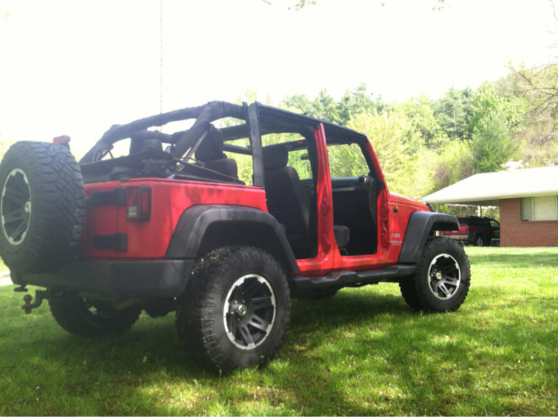

2012 was when the new engine was put into production. As for me, Im more of a camping back woods riding type. I dont rock crawl and I went with the teraflex puck leveling kit, quick discos, rugged ridge wheels and 33" duratracks. I love this set up. I get 16mpg in town and recetly took a vacation and on the interstate I hit 21.8 and couldnt be more happier, but keep inmind I have a 2012 with the new 3.6. I had a 08 and it was a dog while stock, youll be wanting to regear if you go with a bigger tire if you live where there are hills or mountains to climb.
