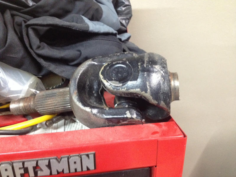

Yep.

Originally Posted by Ringer
Yep. <img src="https://www.jk-forum.com/forums/attachment.php?attachmentid=576270"/>
I just spoke to a buddy of mine today who was on a trail run in Montana. He said 5 jeeps snapped their front axles. All were running lockers. 2 Rubi's and 2 Non Rubi JK and his Cherokee. The 3 were D30's with lockers and the Rubi's. He said all five vehicles broke just like this photo. I'm thinking they were locked and had all 4 tires on solid traction surfaces and he confirmed it. Two of the vehicles were within 2 years new.
