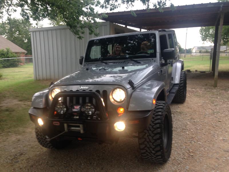

I have a ARB deluxe front and rear bumpers. I also have a WARN 10,000lb winch on the front. I have lost an inch of lift from the weight. I'm thinking of adding 1 inch coil spacers to pick it back up to the 3 inch lift I have. Especially now that I went from 33's to 35's.Click image for larger version
