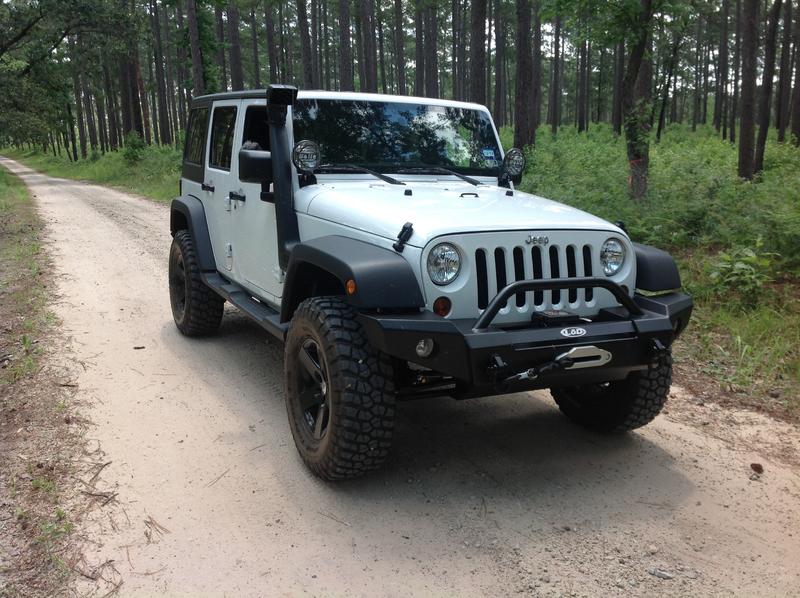

I went with the ARB simply because I couldn't see cutting a chunk out of the hood where the strengthening rib is located.
