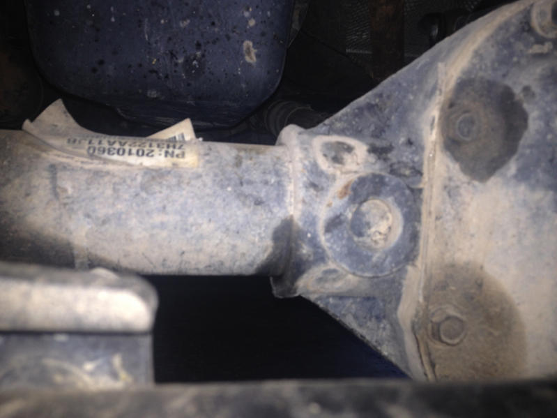

I really pushed my jeep to the limit today! I have an X with a 3" lift and 33" inch tires. I don't have any armor or upgraded axles or lockers. As I was airing up and reconnecting my end links I noticed my axle housing had fluid on the passenger side. I thought it was oil but didn't see any wetness from the engine. I looked a little closer and finally found the origin of the leak. It's coming from where the axle tube meets the diff housing!! :(
It's not a profuse leak but would still like to know if there is a possibility of fixing that. If not, I guess my axle upgrade will be coming sooner rather than later.

If it's leaking at where the tube is pressed in, I wonder if it could just be caulked up?

Here is what I would do. I think the tube is just pressed in. If it is welded, check the welds. If they are OK and the leak is very minor (more of a staining than dripping), I'd ignore it - just keep an eye on the fluid. If it is dripping out, it will need to be fixed via welding or RTV/sealant (or warranty if you have one).
This also assumes it really is coming from there. Clean the are very well with a solvent)carb or brake cleaner) and see if the leak returns. It may just be a grease or oil blob you picked up.

It is definitely coming from the under side of the tube. I still have a warranty but don't know if I could convince the dealership of it not happening while I was wheelin.

They would have to prove otherwise to not warranty it. Just make sure the Jeep is super clean before taking in. Good luck.
