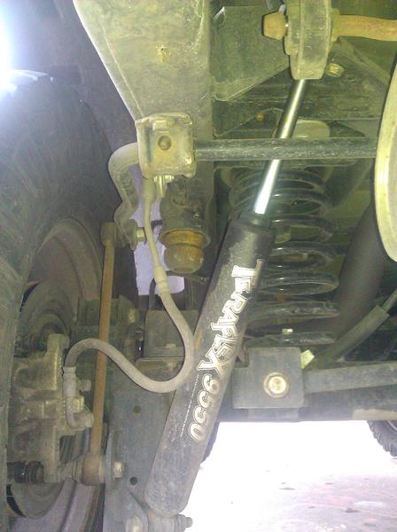

Have you checked your shocks? I had the same issue and it turns out all four of my Teraflex shocks were blown. They replaced them and the ride is a million times better.. snap a picture at your tires and you'll get some good feedback.. Here's what mine looked like shot..
