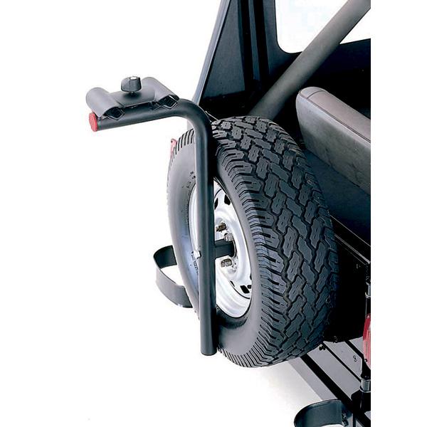

Hey all,
Has anyone seen an offset adapter for a thule spare me rack (or any spare mounted bike rack) that will allow a 35" spare? I heard of a guy who has made them, even supposedly lives in my area (middle tn), but I never got his contact info, and managed to lose the info I had for a go-between. Any advice would help!

not really an answer your question but
Do you have the Thule 963 Spare Me or the 963XT?
The XT (a newer version) handles my spare with plenty of room. I think it has a longer bolt. I only have the stock BFG 32s (Rubi) so I can't say if it fits up to a 35. But if you have the older rack maybe Thule or your bike shop can get you the longer bolt. Thule probably has a spare parts catalog online.

let me know if you find one.. I'm thinking about cutting the bar on top and bending it up to make it fit. the problem that I am having now though, is that my 35s on stock carrier doesn't touch the bumpstops with the bracket on..

My receiver Yakima rack was snug against the gate-mounted spare and is similarly tight against the spare on the LōD swingout carrier.
I'd love to drop and extend the mount a few inches. It's a relatively simple welded assembly, but the market is small.
There is this one on Amazon that was intended for the bike rack to go in the top hole, but it could easily be installed upside down. It's only $37, but the $16 shipping is ridiculous.

i battled this for over a year - even cut the end off the thule mounting plate and was planning to weld it back on with an extension - then found this rack that works on oversized tires, not as nice as the thule, but at least i have a bike transport...
