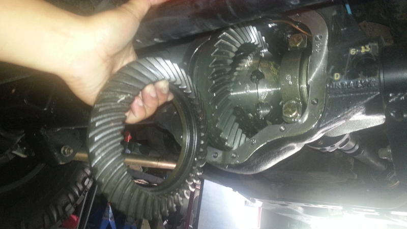

comparison of d30 to a 44 ring and pinion is big, I saved up for the pr44 and have no regrets. I literally plowed into a rock where all tires were spinning, and locked, and aired down, the impact was all on the axle housing, there was no structural damaged.
