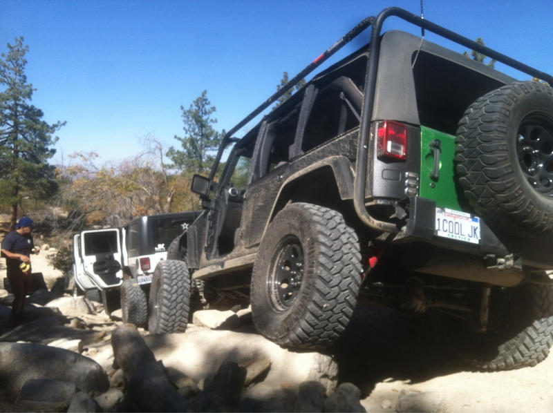

ive done something close to that.. I took ratchet straps to the bars coming up from my roof rack (body armor rack)
