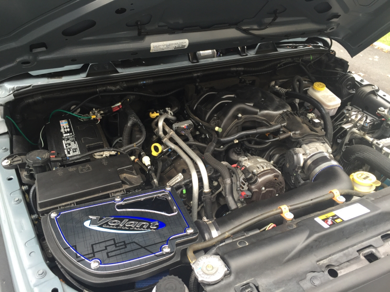

The CAI's duct is slightly larger than stock ...
More air flow to your engine ....plus it sounds really sweet !!
Attachment 629611
The intake duct may be larger, but the throttle body, intake manifold, and intake ports are still the same size. You only get power out of CAIs when you port the head, which I haven't heard of anybody doing.
Out of any CAIs out there, the Volant is probably the best. It's the only one I've seen with a decent air box protecting the filter. The 100,000 mile Powercore filter is probably the only reason I still have it. I have the prefilter mesh screen over my filter to help protect it from splashes, but I still wouldn't be doing any fording with my intake. The only thing I've noticed with it is slightly lower intake temps (10-15 degrees less than ambient). There is no noticeable difference in HP or MPG. I'm planning on getting a supercharger at some point in the near future, so I'll probably go back to the stock intake when I do that.
