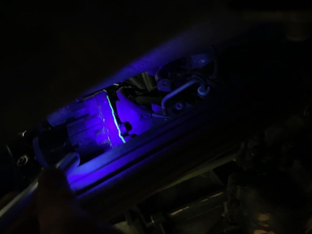

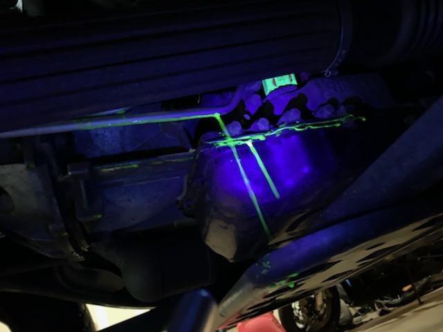

That's a LIM gasket leak.
Here's a couple pics I took when my LIM gasket on my 3.8L started to leak. Driver's side.
The symptoms sound about right as well. It won't leak when the engine is cool since the engine contracts and things tend to seal back up. When the engine warms up, things expand and out comes the water/coolant from every tiny gap there is.
