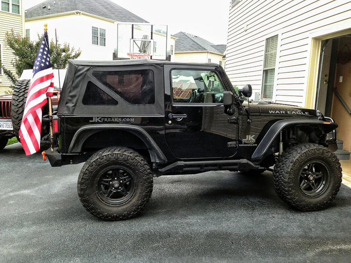

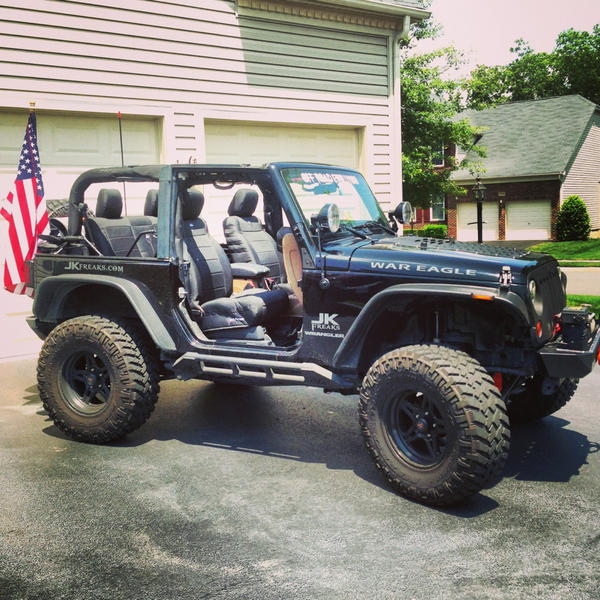

Hey guys, I've had my evo rails on the Jeep for quite some time now, and I had originally bedlined them. Now I'm really not liking the look of the berliner and I was wondering if I have any options as to painting it with a different type of rattle can paint. Would I have to go through the chore of sanding them down first? I doubt the paint would bond to the bedliner (rustoleum) but I'm not sure. Does anyone have ideas? Here's some pictures just to look at..

bump.. Can I just rattle can flat black paint over the bedliner or will that be a bad idea?

Plasti dip over top won't hold up well but super ready to touch up.
Sent from my DROID RAZR using Tapatalk 4
Old Sep 4, 2013 | 06:16 PM
nik81818's Avatar
Joined: Mar 2013
Posts: 761
From: san jose ca
But I think u can spray paint over top it'll just keep that same texture but not sparkle
Old Sep 4, 2013 | 06:18 PM
v8zracer260z's Avatar
Veteran: Marine Corp
Posts: 1,326
From: Keystone Heights
No much will stick to bed liner without removing it or roughing it up real good. Sand blasting would be the way to go and not too expensive.
Old Sep 5, 2013 | 01:58 AM
Mark Doiron's Avatar
Posts: 14,800
Likes: 374
From: Midwest City, OK
Originally Posted by v8zracer260z
... Sand blasting would be the way to go and not too expensive.
^^^^This. Here in OKC we have a shop that's all they do is sandblast--he'd be done with your rock rails in ten minutes. Check around your area for a similar service.
