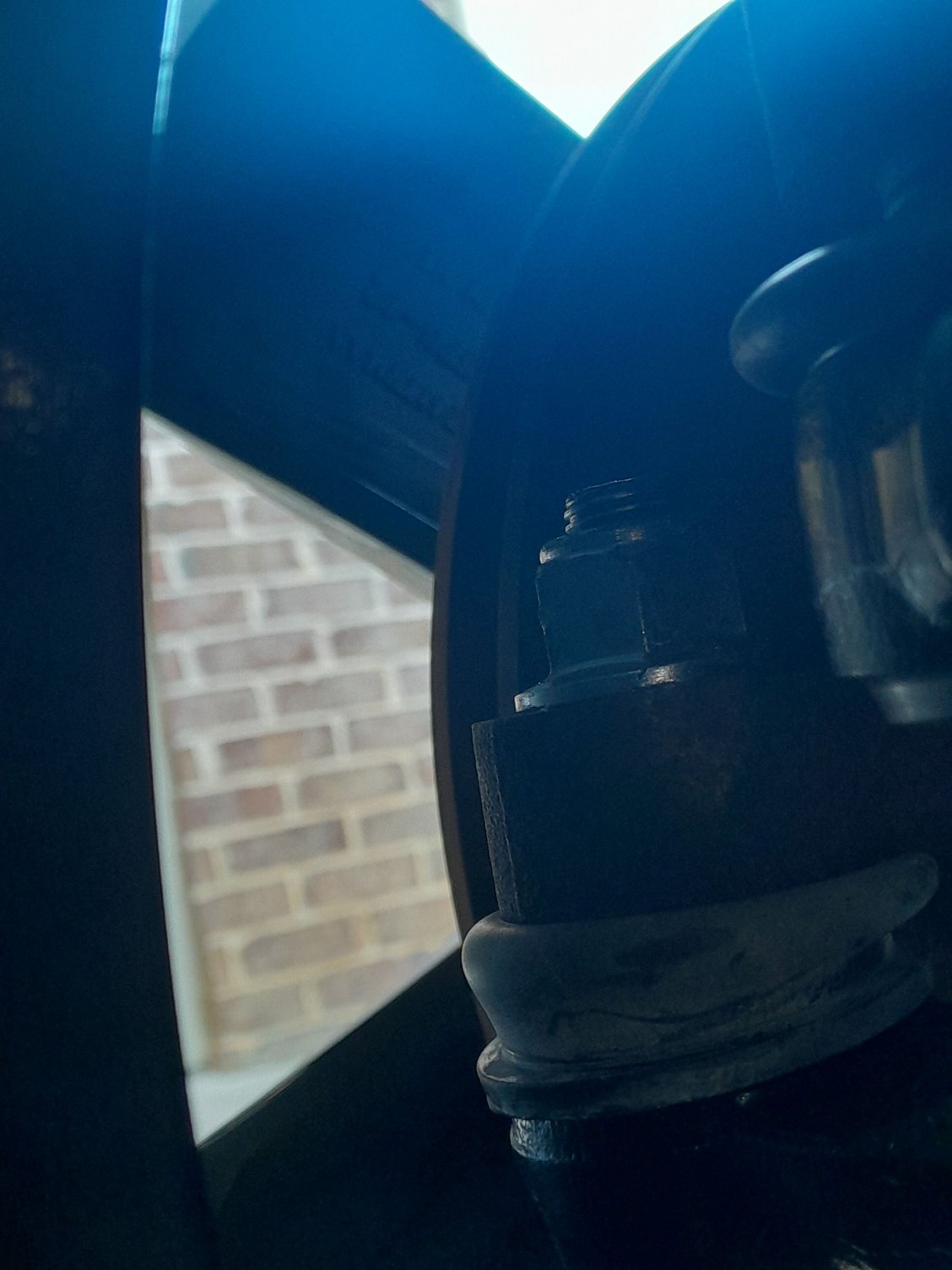

Does this nut on the end of my drag link to the pitman arm look OK? I'm concerned there isn't enough thread sticking out of the top.

For reference, this is the other nut.

It is a 2007 JKU with 140K miles I purchased about a month ago. The exterior and interior are great but the previous owner neglected a lot of maintenance. When I got it an alignment shop couldn't get the wheel centered and it drove erratically all over the road. I noticed the track bar had movement so I bought a new one and replaced with Grade 8 9/16 bolts. That helped but it was still all over the place. I adjusted the steering box and that got rid of a little play. Yesterday, I installed new tie rod and drag link. The feel of the steering is night and day. Once it was in though the steering wheel was way off and I had to use all my muscle to get the adjusting sleeve turned on the drag link to get it straight. I'm certain it shouldn't have been that difficult to adjust the steering and that's what has me concerned this end may not be seated properly (is that even possible?). It's driving great today though. I'm about to install a new SS and lower control arms this afternoon... trying to give everything an overhaul.
The Jeep is stock. The parts I'm replacing with are all OEM replacements that I either ordered on-line or got from a local parts store. The drag link in question came from advanced auto.
I'm tempted to pull the drag link end off to inspect it but I destroyed the old one beating it off yesterday. I'm afraid the same will happen to this one. Would it come off easy since it's brand new?
My wife and kids will be riding with me in this Jeep so I'm after safety more than anything else right now. I'd appreciate any feedback. All the images I'm finding on Google are aftermarket or have the castle nuts so I can't really compare mine to anything.

Also, I couldn't get my torque wrench to that nut so I tightened it down as good as I could. It's not moving. If anything it may be a little over torqued.

Yes, that location is about impossible to get a proper torque wrench on. We all just do our best to get it tight. I wouldn't worry about that at all. That tapered stud is solid up into the pitman arm and it's not going anywhere.

Thanks resharp. I felt like it was good but wanted a little reassurance. I took the nut off and pushed up from underneath and there was no movement. The whole Jeep was lifting. I'm going to mark it for now and keep an eye on it.
