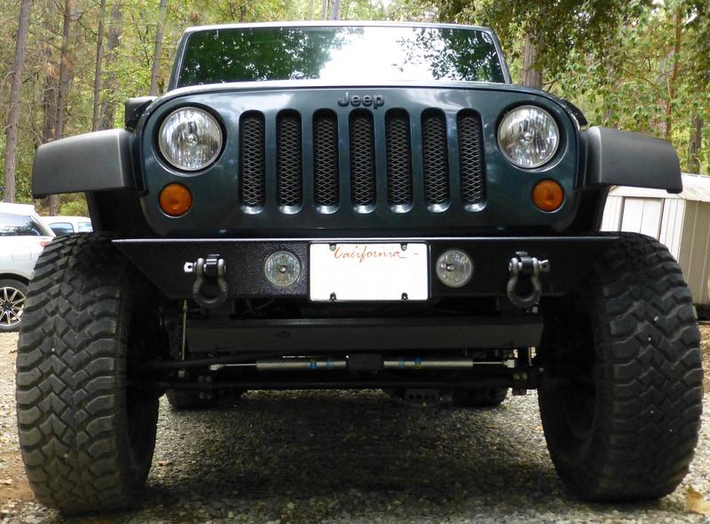

edit" IMO -a gas charged stblzr like Bilstein or Fox work really well. Some people don't think stbzlrs are even neccessary, but I've been very happy with running dual Bilstein's. Works great for me

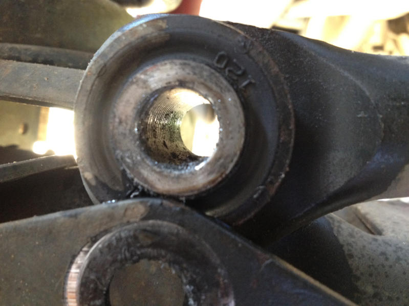

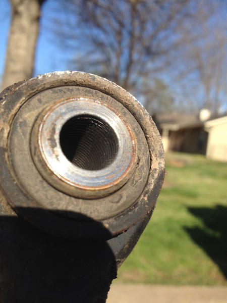

Here's a couple picks of what was causing my DW.
ID:	378690   Click image for larger version
