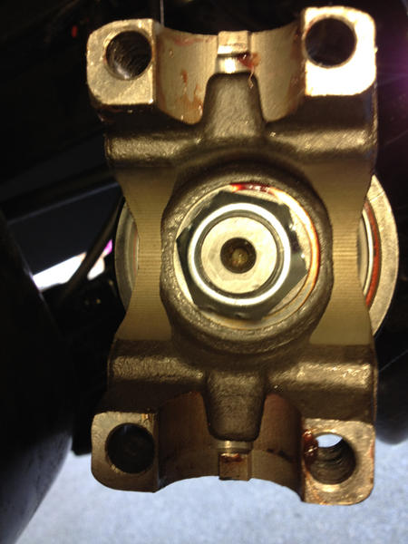

The tabs on the pinion yoke were not milled to the same width so consequently the u-joint won't fit.
Guess I'll be calling Dynatrac in the morning.

Ouch that sucks, its quiet obvious too :(

Nope- not obvious at all and it only needs to be off by a couple of thousands to cause an issue. This is the second one we've had. We'll take care of it. Call me in the AM.

It was pretty obvious to me because the u-joint wouldn't fit, looks like 1-2 mm off to me. Was wondering if you do a test fit before sending them out?
I appreciate the quick response and will call in the morning.
Thanks!!!

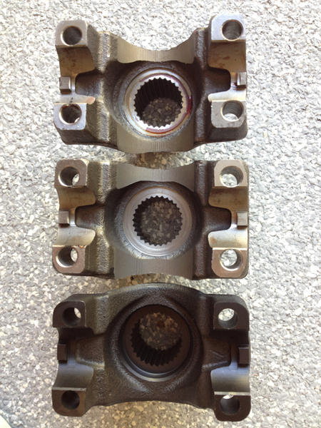

-Ok so last Friday I received my second yoke from Dynatrac and the U-joint on the driveshaft I got from JE Reel still would not fit in between the yoke tabs!!! ( so now I have bought two yokes from Dynatrac neither of which work )...
-Scott from Dynatrac suggested that maybe there was a problem with the U-Joint so I called JE-Reel and ordered a third yoke.
-Yesterday the Yoke from JE-Reel showed up and guess what, the U-joint fits perfectly between the yoke tabs!
-FYI Jim at JE-Reel was very helpful i highly recommend his product and customer service.
-I called Dynatrac and needless to say Scott was pretty much blown away. I felt like I should have been offered something for my troubles, maybe a discount on my 4500.00 rear end that I had to RnD to get to work. But no such luck.....
What i learned?
1) The most expensive does not always mean the best or its perfect
2) Dynatrac gets their yokes from someone else and they obviously do not have quality control and they do not test fit there product
3) you cant tell Dynatrac there is something wrong with there product and actually have them believe you until you take it on your own to prove otherwise.
4) DO I HAVE TO WORRY ABOUT THE QUALITY OF THE REST OF THE REAR END?! I had future plans for a pro-rock 44....
5) Jim at JE Reel Rocks

Top two are supplied from Dynatrac
Bottom is from JE-Reel
Jim at JE-Reel had a good suggestion.
Maybe Dynatrac should get there yokes from him
