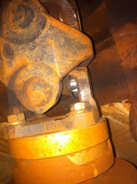

So my jk was making a horrible noise today on my way to work crawled under neath didn't notice any thing. Well got home and found this!! A cracked and chipped roller sleeve thing on my u joint for my rear drive shaft... I have no clue what after market drive shaft is on the rear. So I don't know if there are different sizes or what not for u joints!??? And is it ok for me to drive to work tomorrow on it? It's about 30 miles round trip... Please help

No i would not drive it like that. If it fails on the to or from work, ur riding the renta a wrecker home method. It is either a 1350 or 1310 u-joint( most likely a 1310.). These are common component in aftermarket driveshafts for jk. Any autoparts store has them in stock.
Call in sick and find a local repair shop( or u can do the replacement urself but since u dont even know what it is-i recommend u let a mechanic fix it). A local flatbed ( just do not let them tow one end or the other of ur jeep- all 4 wheels must come off the ground. Period) wrecker can be had for 40-60 bucks or u shop around in the phone book. Have them tow u to the shop and let mechanic work thier magic. If u are not mechanically enabled- owning a modified jeep can be expensive hobby.
And again- no u cant drive it like that for long. When it does give up, the damage will be much more expensive and u still have to ride the wrecker!

Thanks for the tip. Yes I know it's an expensive hobby!! I have built 90% of my rig myself in the garage... So yes I am mechanical inclined!! Lol I mean besides not knowing the proper name for the roller thing on a u joint.. I'll hit up napa first thing in the morning! Hope this beast makes it atleast 13 miles or looks like I'm getting some cooler parts!! Atlas?? Maybe sooner than never lol

I believe that part of the u joint is refered to as the bearing cap. Someone chime in if u have heard another name for it.

Oh by the way- make sure its a Spicer branded u joint that is greasable after installed. Very important. Alot of the prands out there are chinese garbage ujoints that will fail. Spicers are king. Good luck.

Yeah I already knew about splicer, thanks!! Also checked out the TW sucks thread before I posted, just flashed through it. Also found that 4wheelparts has a ruler you can print out the you can measure the u joint or the flange. Food for thought for everyone else out there

Just remove your rear shaft and then you can drive in 4 hi to the shop of your choice to replace your U-joint.
X2. Been there. Done that. Just not on the JK...yet
