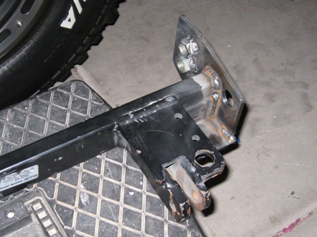

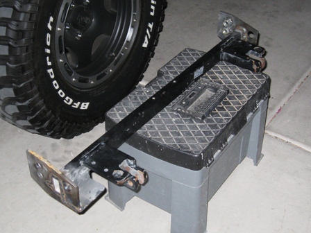

Similar in concept to what you want to do I had an old Demco baseplate modified so it would slip between the AEV tow tabs which could be done with most any baseplate I would think. Two nuts are welded to each side of the mount so all that is needed when I want to tow is bolt the bar on with two grade 8 bolts per side then I can attach my Aluminator tow bar to the original baseplate tabs located on the modified baseplate. I had it fabbed up and now need to have it powder coated. The downside of course is you need to start with a baseplate. It works with the AEV skid intact.

Thanks alot for the pic's, that explains what needs to be done. I was considering getting a couple of brackets made to adapt from the AEV tow tabs to the blue ox/roadmaster tow bar. But after looking at your pics it looks like a better idea to make a "spreader" bar between the AEV tow tabs and then mount the tow bar to the spreader.
