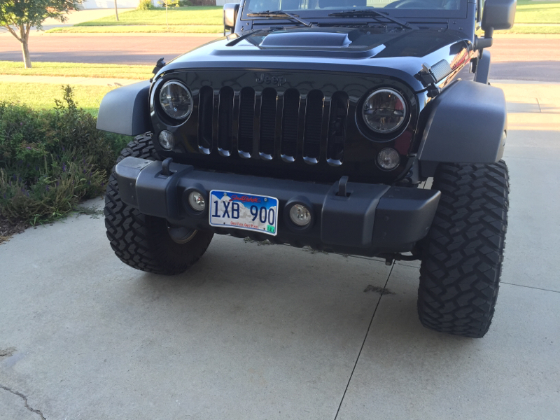

If you got a little cash, a sawzall and a smidge of mechanical skills you can buy stubby bumper caps for like $80. you cut i believe 3 1/2 inches off each end of the bumper and screw the caps onto the bumper. A lot of folks think the stubby looks better and it allows more turning clearance for larger tires.
Here's a pic of the Vertically Driven Product's end caps on mine before I replaced the bumpers. Easy 15 minute upgrade!!
