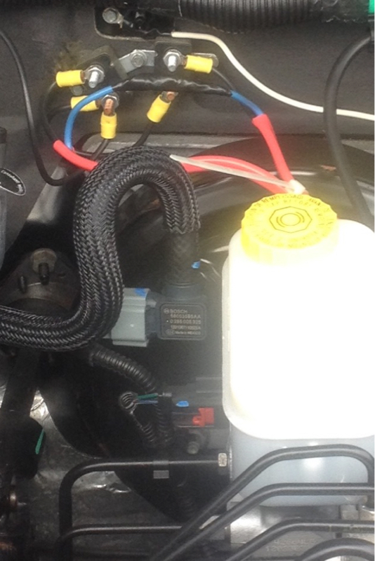

happened to me. Was not the gas cap. It was a very slight air escape in the tube that goes into the Evap canister. I tweaked that tube. The gas cap message went out and never came back. That was 2 years ago. Here is a picture of the hose I'm talking about.
