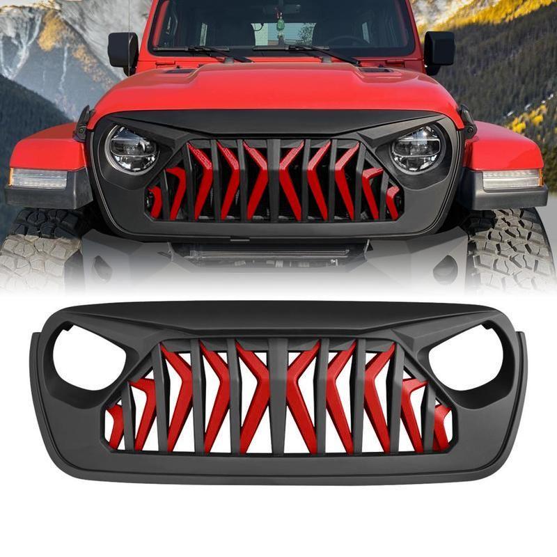

I just ordered this black shark grill off of someone, I think it’ll look nice on my red
jeep with how I’m thinking of customizing it. I want to repaint it a glossy black and add some red tones into it kind of how the Bloody Black shark grill looks like buuuuttt not exactly. I just don’t know what paints/primers/whatever tf else I need to use. Help with recommendations please?

A Double Welcome to The Forum for both our Newbies ! Best source for info, IMO, would be a body shop on what the prep process would be and what procedure/paint to use. You should check youtube for some videos on painting plastic.
Old Apr 23, 2024 | 06:43 AM
XJRefugee's Avatar
Joined: May 2021
Posts: 265
Likes: 80
From: fountain hills, arizona
Painting plastic and getting it to stick over the long term is the issue. Be sure and use paint meant for plastic (Krylon) or better yet use a plastic adhesion promoter under your topcoat paint. Sand lightly using scotchbrite pads this will keep scratches to a minimum. I used plasti-drip paint the kind that peels off. Also used this same type paint in the rear wheel wells after removing the wheel liner. It has held up quite well.
