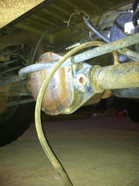

Just got home and saw this hanging out the back of my jeep. What is it and where does it go?!!

Edited. There now?

its ur axle breather tube, it clips onto the frame, just tape it up for now i guess, or check out the thread on extending ur breather tubes

Looks like breather tube. Forget exactly where it goes up at

Diff breather hose.

Its the rear differential vent tube. It ties up near the Passenger Rear Tail light under the tub or onthe frame..I think. Should be a white plastic plug to keep other debris out. Hope this helps.

It is just the diff breather tube. Looks like a good time to do the breather tube extension mod.
