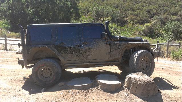

Ok still new to the 4x4 world and jk is my first. Went offroading the other day and came to a point where it was steep and was very nervous so i turned around. I didnt want to go down riding my breaks so what can i do for future referance. I was also alone and didnt want to do somthing dumb and be stuck out there otherwise i would have done it no problem, i was just concerned if i braked i would slip on lose dirt and slide. Should i put it in 4low 1 and descend. Any help would be great thanks. Oh and heres a pic of the little guy
