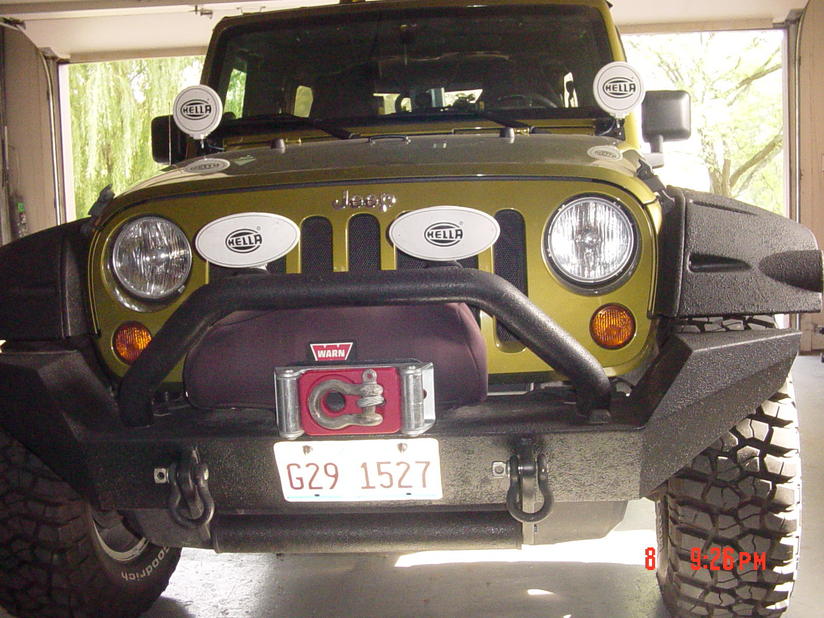

i used it on my fender flares and it came out a little to aggressive for me so my fix was , go over it with regular bed liner that will smooth it out , they might even have colors just keep it clean around the floor plugs this is how mine turned out on the front bumper and flairs
