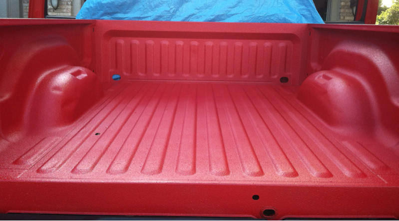

So the Raptor liner yourself. $110 comes with everything you need and looks like lineX. I did my truck bed and color matched it...
That looks fantastic. Nice job.

Thanks! Ill be doing the tub of our JKU this spring and our new JCR rear Dagger bumper. One thing I will do different is get that cup brush sanding attachment that goes on a high speed buffer ... Hand sanding a bed is way to much like work
